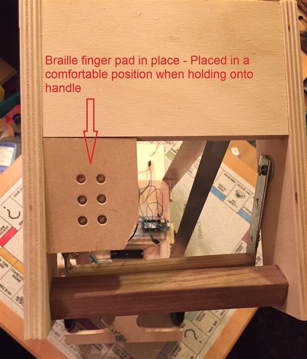

This blog is to do with assembling the SeeingEyeduino. In the past week I have made up most of the remaining parts for my project. The Braille finger pad was the most important part of this project. Below are pictures of where I am at, I will explain each photo and give details. If there is anything you have questions, comments or ideas on, please leave a reply. Every little bit helps!!

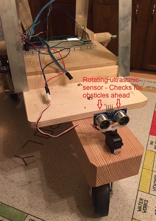

Below is the ultrasonic sensor attached to the servo to check for obstacles ahead.

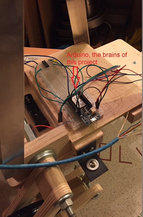

I attached the Arduino to a breadboard  to make it easier for attaching the wiring. On the other end of the breadboard is the L298 IC motor controller (This may or may not be used at this time as I will probably not be using the drive motors)

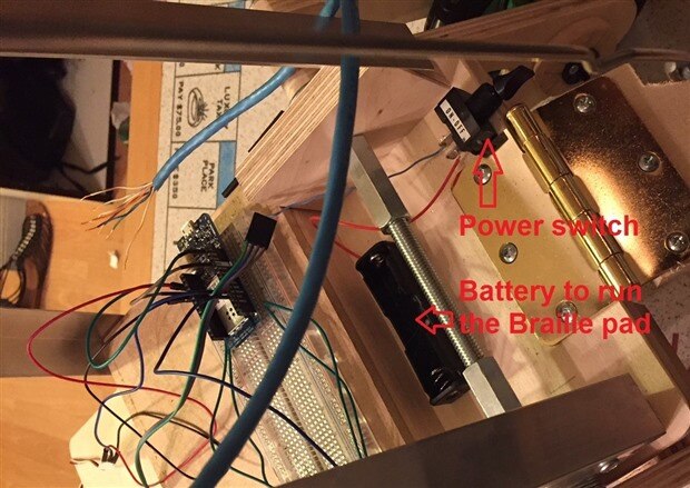

Here I have the battery slot to run the Braille pad. It take a 18650 3.7v battery. I also added in a power switch, this will be moved to where you hold onto the SeeingEyeduino for easy access.
As you can see in the next picture I have the handle and Braille pad. Since I don't have a 3d printer I made it out of wood. The actuators go 1/2 mm above the face of the pad. This makes it a comfortable height.

    Hi Dixon, The Braille pad is small, the top third of your index finger size. The actuators are very small and have just enough power to extend all the way. With little force you can push them down, I had…
