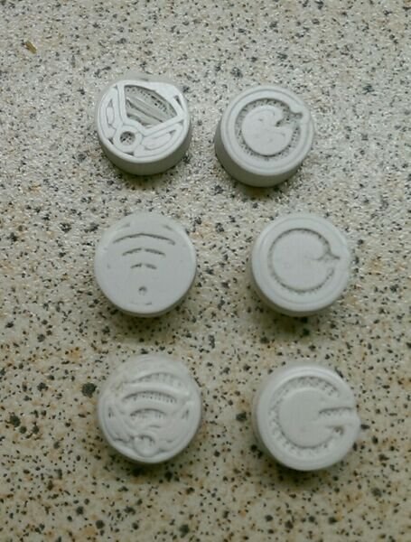

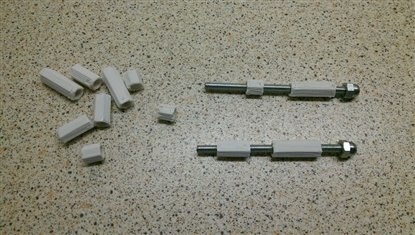

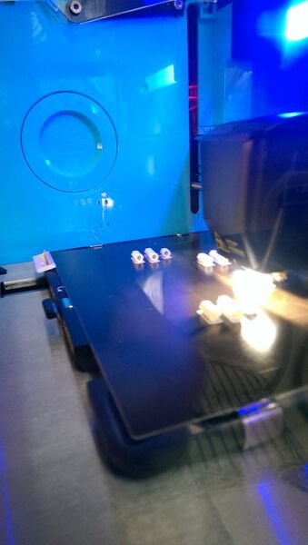

However not everything was so simple. After quite a few failures the spacers for supporting the Yún and shields were printed successfully by lying the models down, reducing the printing speed and printing at 1/2 speed for the first few layers. Also a brim was added as the footprint was quite small.

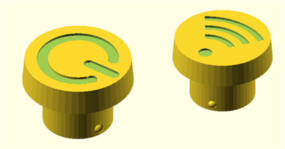

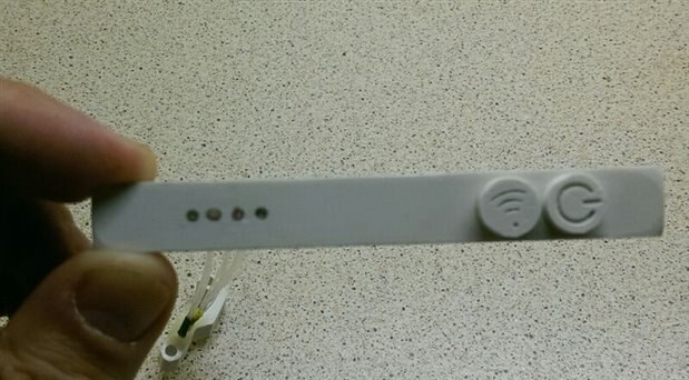

The final challenge for the printing was two buttons for the top panel. These went through several iterations and failed prints but eventually a design was created that fitted the panel and printed successfully. The small bobble on the stalk stops the buttons falling out when you turn the panel upside down.
The key lessons learnt here were not to have features too close to the edge, the printer can handle thin slots but not thin solid, adding a brim helps give a crisp edge and when printing the first layer don't make it too thin and print it slowly.
There was a little clean up of the wifi logo needed but the power button was simply a case of removing the brim.

    The buttons could have been made very easily on a lathe and then the logos carved into the tops with a mini drill or engraver. The design had to be optimised for printing, I'm sure the same would have applied if I was using other techniques.
