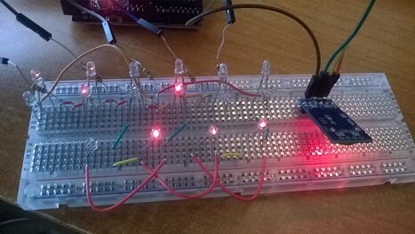

Hello everyone,
So I have been programming the Arduino for enchanted clock I'm building (Work in progress). I am still having issues with the SAMA5D4 Xplained, I may have to change to an RPi if time starts to get tight. I really don't want to do this as our sponsors have been very generous and I don't want to let them down.

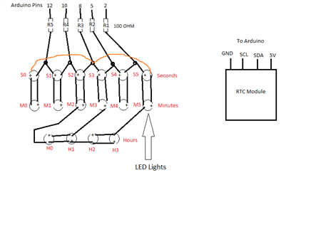

So to update where I am at. I have decided that for the clock to stay in time due to the inconsistency in a wood clock, I have made a binary clock. This clock will be integrated with my wood clock and through servos it will re-set it to the correct time. Below is a picture of the Binary Clock on the breadboard working. I will make a PCB board cape for final product. The time on the Binary Clock will be seen as well as the wood clock time.
Schematic:
Clock Code:

    It took me a while to work out the LED wiring but I got it eventually, very cunning.
    mcb1 over 11 years ago +2
    How long did it take you to work out that wiring. I had a headache just trying to follow it ... full marks. Mark

    When i started the wiring I had hair, I now am bald!! I have done a PCB cape with CADsoft, I will upload the .brd File for those who would like it. My family thinks the binary clock is pretty cool, but confusing. For those who don't know how to read the time off of the binary clock, here is a quick description:
    BInary language works on 0's and 1's, on or off. The first light is 0 or 1, the second is 0 or 2, third is 0 or 4... Etc. So, if the seconds line = 001101 this would be 44 seconds. Explained: with the 3rd, 4th and 6th light on you add 4 + 8 + 32.
    the hour line only has 4 lights as we only need to goto 12, eg.. 0011 = 12 or 1010 = 5
    TIme on my clock in picture:
    110000 : Seconds
    010100 : Minutes
    0111 : Hours
    14:10:03 or 2:10:03 pm
    Easy, eh!!
