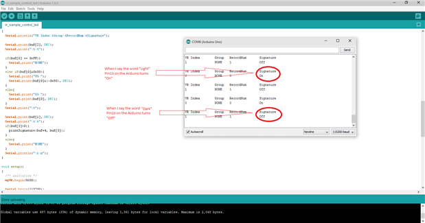

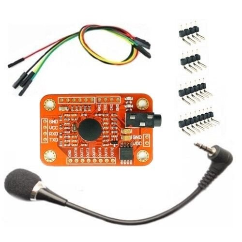

I am using the Voice Recognition Module V3 "Speak to Control".
It is a speaker-dependent voice recognition module. It supports up to 80 voice commands in all. Max 7 voice commands could work at the same time. Any sound could be trained as command. This board has 2 ways to control: Serial Port (full function), General Input Pins (part of function). General Output Pins on the board could generate several kinds of waves while corresponding voice command was recognized.
Controllers information:
Parameter
● Voltage: 4.5-5.5V
● Current: <40mA
● Digital Interface: 5V TTL level for UART interface and GPIO
● Analog Interface: 3.5mm mono-channel microphone connector + microphone pin interface
● Size: 31mm x 50mm
● Recognition accuracy: 99% (under ideal environment)
Feature
● Support maximum 80 voice commands, with each voice 1500ms (one or two words speaking)
● Maximum 7 voice commands effective at same time
● Arduino library is supplied
● Easy Control: UART/GPIO
● User-control General Pin Output
Here is a link to the Voice Recognition V3 Arduino library (Download zip file)
Below are pictures of the module, programming the module and a video of it in operation:

    dwinhold over 11 years ago in reply to Workshopshed +1
    The nice thing about this module is you don't require a usb-ttl adaptor to program it. It can all be done through the Arduion.

  • Workshopshed
    Hi Dale, Chrystal,
    that's an interesting module, they are obviously keen for people not to reverse engineer the board as they've gone to the effort of potting it. I see on the website that even the previous version has the manufacturer details removed from the chip  http://www.elechouse.com/elechouse/index.php?main_page=product_info&cPath=168_170&products_id=2151
