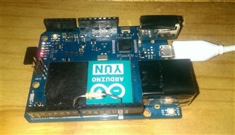

Hans looked at the Arduino code and noticed that the size was 10% bigger when he compiled in the Bridge libraries. Looking at the code it was obvious why. There was code for handling web servers, email and code to start and stop the bridge and check it was running. Following Ambrogio Galbusera's idea, he decided to drop the bridge and use a simple serial communication instead. The Linino side could start up his Python code directly rather than provide a console with root access listening on the serial pins.
Are you ready yet?

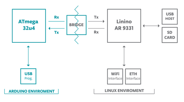

One of the problems of turning off the Linino portion of the Arduino Yún is that it takes some time to restart and you need to know when it's ready for action.
This problem is compounded by the fact that whilst that side is booting the serial connection which is normally used for messaging between the Linino and ATmega sides is used as a console for the Uboot and Linux boot processes. If the ATmega was to send anything across the bridge at that point then it could stop the booting process. The way the Bridge code works is to delay starting until that console has not produced any content for over 1s, however this timing based approach is a little unreliable so some people on the Arduino Forum have suggested adding further delays into the code to ensure that Linux has fully booted.

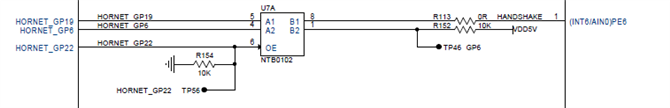

Luckily the system has a hand shaking line installed and that can be used to signal that the process is complete. This is connected up via a level shifter which can be turned on and off via one of the AR 9331's GPIOs.
Eberhard Fahle has produced an article that explains what is needed to configure the handshaking line for the Arduino Yún we can then use that either as a digital line or via the interrupts to signal when the boot process is complete.

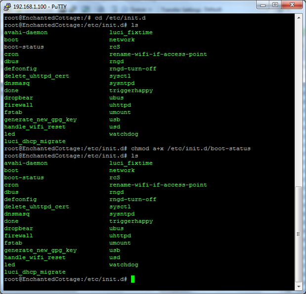

The boot status script was uploaded to the init.d folder and configured for execution.
As suggested in the article the init script was tested with
/etc/init.d/boot-status start
and with
/etc/init.d/boot-status stop

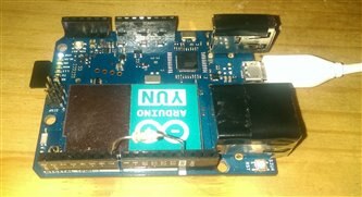

The serial monitor was started and the boot process watched. Shortly after the last message in the console the red #13 light turned on. The boot-status message does not show in the log.
