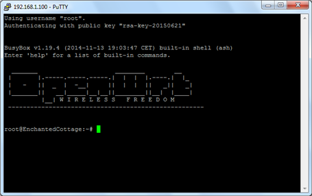

The Enchanted Cottage has some protection against brute force attacks in that the Linino portion and hence the Wifi is turned off for most the the time hence there is no way to connect. However in the computer world the few seconds that the system is up and connected should sufficient for a break to be attempted.
The two areas that could be vulnerable to this are the Web Admin UI provided by Arduino and the SSH port. It might be possible to turn these off. Given that these are used to fix or configure the device that's maybe not a good idea.  It's also possible to configure SSH to use certificates rather than password for login. To do this on the finished product we'd need to have some way of getting the keys back and forth.
This can be setup by following the instructions for setting up Drop Bear SSH for Public/Private Key authentication
