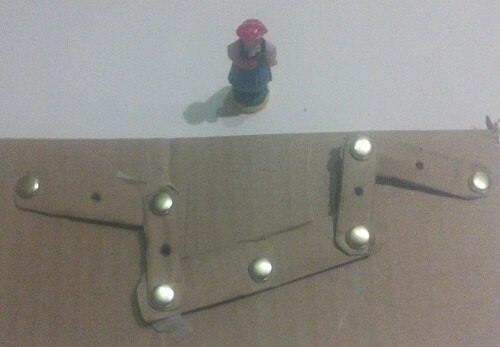

"That” said Matilda, "is not good". Hans looked nervously over the top of Network Security for dummies. He knew that tone of voice and the daughter of a miner is not one to be trifled with.
Matilda held up her mechanism and Hans saw the distinct arc transcribed onto the paper. "Oh" he said.
Several hours later, later the floor was deep in cardboard scraps and scrumpled paper. Matilda looked despondent. "Perhaps the Historical society might be able to help” suggested Hans.
The next morning Matilda headed up the back stairs of the town hall. There, behind the reference library was a small door marked "Historical society”. Behind the small door was a small room piled high with boxes and papers. On a desk she saw the model locomotive from the faire. "Can I help" asked a voice from behind the model. A bespectacled man's face popped up from under the desk. Matilda explained her predicament. "Ah yes" said the man, ”that's a problem engine designers took years to crack. It wrecks the engine efficiency to the point we could not get our model to run". He pointed to a small electric motor attached to the bottom of the model. "Go next door to the reference library and ask for a book on Watt's Linkage” he suggested.
Matilda returned home with a spring in her step and a book under her arm. She quickly made a model of the linkage and confirmed it did indeed generate the desired motion. She silently thanked Mr Watt for his fantastic solution.

    I wanted linear motion and thought the initial design would give me an approximation. However as you can see that still gives an arc based on the beam length. The new design is effectively a double ended…
    mcb1 over 11 years ago +1
    Andy I was thinking of whether a watts linkage would work, when you did the first one. Most applications I've seen either have very long 'arms' or short travel distance, otherwise you get the sligt sideways…

    Workshopshed over 11 years ago in reply to mcb1
    So when the spark is moving up that means that there is a lightening storm approaching?
    mcb1 over 11 years ago in reply to Workshopshed
    Jacobs Ladder referring to a kids toy
    Yep and who can forget the arc eminating upwards in science....
    It's a strange name which has nothing to do with the original greek description ...
    The bigest advantage is the relatively short arms but large linear movement.
  • Workshopshed
    Yes, the jacobs ladder is interesting mechanism and could fit into a smaller space, useful to know.
    I've also heard the term Jacobs Ladder referring to a kids toy using ribbons and blocks which would probably be less useful.
  • Workshopshed
    An experimental beam model, I hope to be able to clip the parts together otherwise I'll resort to bolts or self tapping screws.
    mcb1 over 11 years ago in reply to mcb1
    Jacobs Ladder was the one we used.
    http://tbuckets.lefora.com/topic/4072872/Jacobs-ladder?page=1
    For dirt track it had the advantage of increasing the roll centre, which is why you don't see them on street cars.
    They have very large movement for very little lateral movement.
    Not 100% sure how you would interconnect them in your application, but well worth a look.
