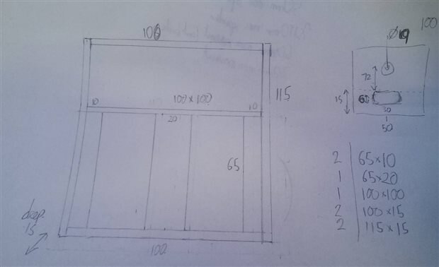

Matilda showed the wood cutter her plans for the basement and rear extension to the enchanted cottage.

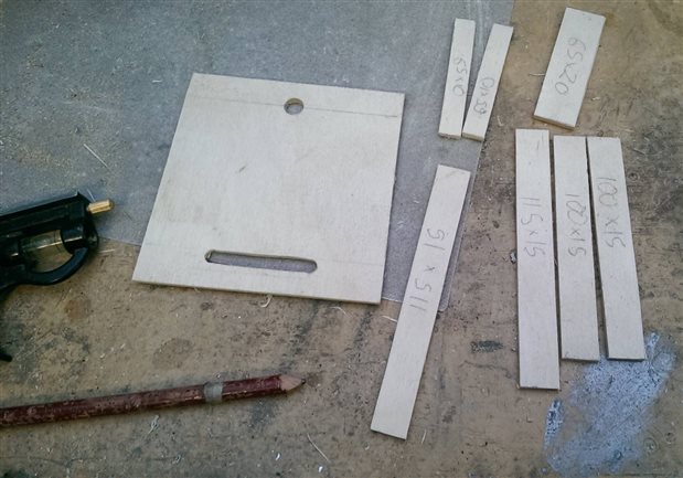

The woodcutter set about one of the fallen trees and soon had it converted into planks for Matilda's design, she helped him load the into the cart and then headed off to see the blacksmith

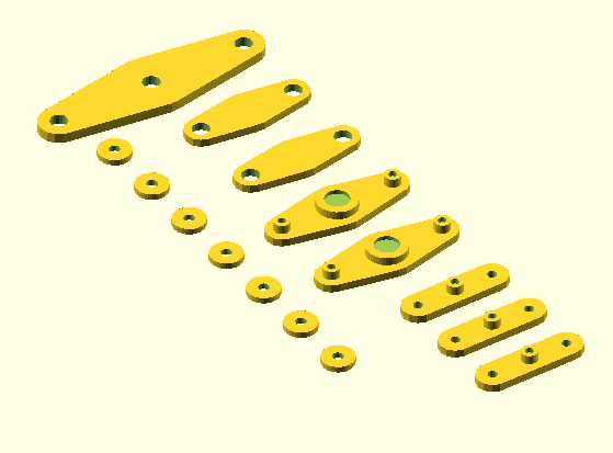

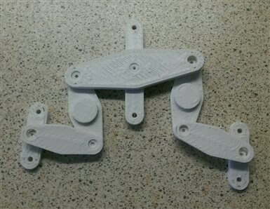

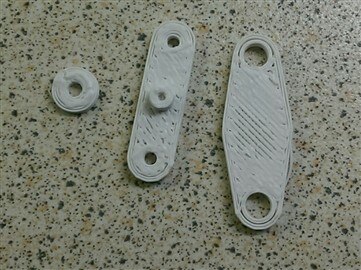

Matilda always liked visiting the Cel the blacksmith as it was always nice and warm in his shop. She showed Cel the plans for the Watt's linkage and the he set about making the first parts.

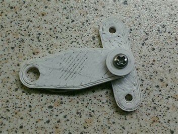

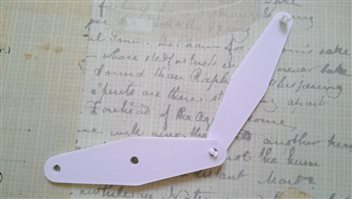

When the tested them the pins were too weak and one snapped off. They both cursed at the wasted time and discussed an alternative. Their second attempt was successful and used a hardened screw to re-enforce the joint.
Matilda redesign all of the parts to work this way and left the plans with the Blacksmith who set about making them.
There were a few changes to the parts over the next few hours but eventually Matilda has a set of components she was happy with.

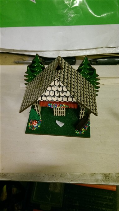

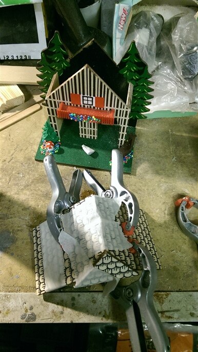

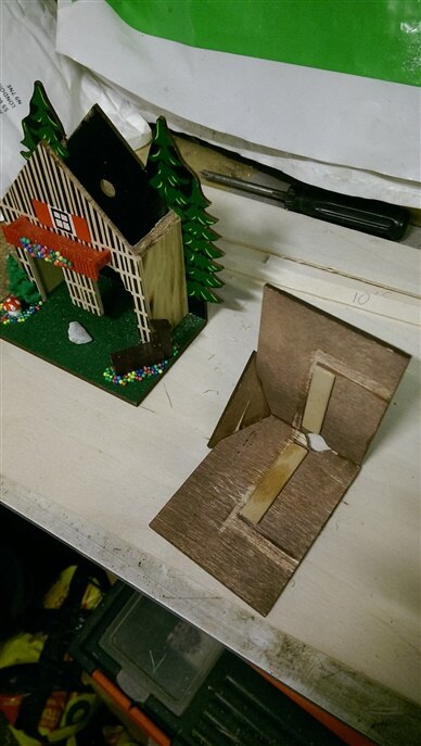

By the time she had returned home, Hans had finished the repairs to the roof
{gallery:width=300,height=400}Roof repairs
Roof Glue up
Roof battens
Roof back on
The next job for Matilda was to put the parts into motion and her thoughts thoughts returned to the words of the woodcutter. Perhaps she thought, rather than directly connecting the servo to her mechanism she could use a springy sapling. Then if anything locked up the sapling would flex rather than causing the servo or mechanism to break.

    Workshopshed over 11 years ago in reply to mcb1 +2
    I was thinking a springy wire, something like this From RC Boat Rudder Linkage
    mcb1 over 11 years ago in reply to Workshopshed +2
    That might work as well. Several ways to skin the cat so to speak.... Mark

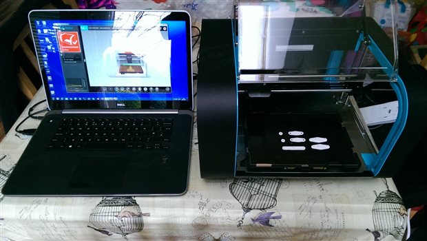

    Note that both the woodwork and 3D printed designs have changed already, so I'll likely re-draw/publish later in the project once things have stabilised on that front. I built a little coping saw table from some scrap wood and laminate flooring to help with sawing the slots.
