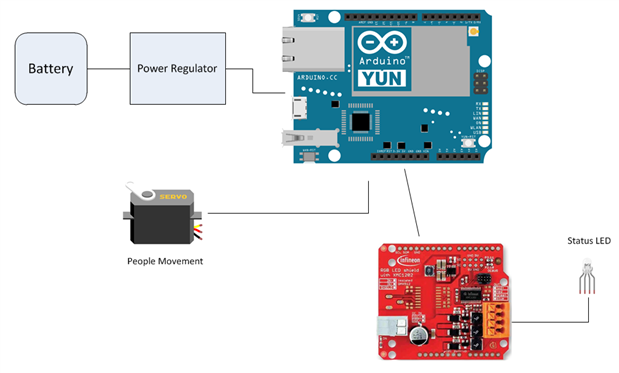

Hans sketched out a rough schematic of the new control system, the power to the cottage was erratic so they did not want to rely on a main supply, the YUN did not have a regulator so Hans knew he was going to need some kind of circuitry for that and perhaps it would be good to charge the battery when there was power available. "Perhaps we could put some solar panels on the roof", he thought out loud. "One step at a time" suggested Matilda and Hans agreed.

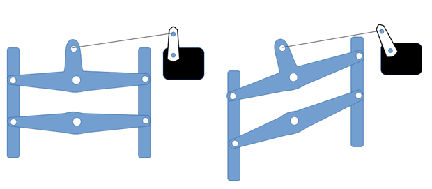

After her exertion, Matilda took a well deserved break and went with Hans to visit the town faire. Between the stalls and rides Matilda spotted something from her childhood. The town historical society had restored one of the old locomotives that pulled the coal wagons. She marvelled at how it's linkages converted the linear motion of the pistons into rotary motion for the wheel. When she got home she sketched out a mechanism for connecting up the servo to the movement in and out of the house.

    Like Matilda having that beam and a hole in the front of the wall is one of the things I dislike about the traditional approach. I made a prototype of the mechanism with split pins and card, I need to…

    I need to measure their current draw to be able to size my battery appropriately
    Don't forget the large capacitor so that the start current of the servo motor doesn't cause glitches....
  • Workshopshed
    Hopefully will be looking at the servos this week, I need to measure their current draw to be able to size my battery appropriately.
