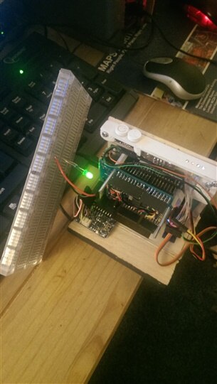

Due to the modular nature of the design the boards and components could be tested as they were assembled. The boards were tested with modified versions of the example code that were originally used in the development. Prior to assembly the proto-shield was visually inspected for problems.
Test code and example: https://github.com/Workshopshed/EnchantedObjects/tree/master/Code/Examples
Powerup Test
All the plugged components were removed, the Arduino Yún and Protoshield were plugged together and it was powered up from the micro USB connector. This tests that there are no serious faults with either board. The LED light pipes were visually inspected and although there was a little bleeding of light between the outputs the overall result was acceptable.
Knock Knock and Top Panel Buttons
The knock knock sensor was plugged in and tested. This did not work as expected and was tracked to a dry joint on one of the power wires on the protoshield. Whilst trying to diagnose that issue a short sketch was written that output the button status to the serial port for monitoring and this was used to test the top panel buttons. A note was added to ensure connectors pushed on properly.

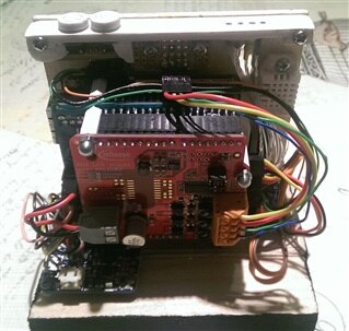

Infineon RGB test
The last shield was fitted and the wires added. The LED did not turn on and the code froze on LED.begin(), this was identified as the I2C pins connecting the protoshield headers as being open circuit. They were re-soldered and the LED worked.

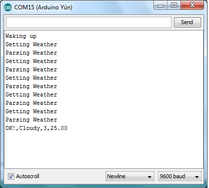

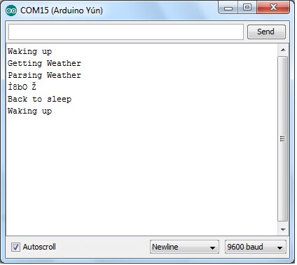

Serial Bridge
So that the state model and bridge could be tested, the code was scattered with messages to send back to the computer. The state model was working correctly but the weather returned was gibberish.
The SerialParse script was installed to send the request to the Linino. The weather-daemon was stopped and ran manually.
This returned the error.
ERR,[Errno 2] No such file or directory: '/etc/WeatherAPI.conf',3,10.00
The missing file was copied on and a new error appeared
OK!,Cloudy,3,26.00
Traceback (most recent call last):
  File "/mnt/sda1/Python/GetWeather.py", line 217, in <module>
    sys.exit(main())
  File "/mnt/sda1/Python/GetWeather.py", line 200, in main
    ser.write(w)
  File "/usr/lib/python2.7/site-packages/serial/serialposix.py", line 363, in write
    raise TypeError('expected str, got %s' % type(data))
TypeError: expected str, got <type 'unicode'>
This showed that the weather was being read correctly but the script was failing to send it back to bridge.
Googling showed that this was an encoding issue pyserial ser.write('string') TypeError in OS X | Python | Python
The change was made to the code and it correctly returned the weather to the Arduino.

The main code was still erroring, seemingly returning junk back to the Arduino. However, when it was left for a period, subsequent reads did successfully return the weather. This was repeatable.
A simple flush command was written to ensure that the serial buffer was cleared of any booting garbage before requesting the weather.
void CONTROLLER::flushserial() {
    while (_serial->available()) {
     int inByte = _serial->read();
This did not help with the problem so a simple retry mechanism was added to the code.
That approach worked.
The code is not perfect but it's enough for a demo to be recorded.
I'm speculating that the handshaking line is going high too soon as it's fired off by a different process to the weather-daemon. Perhaps a resolution would be to toggle that GPIO line in the Python code instead.
