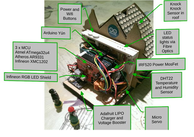

The build for the Enchanted Cottage was not all smooth progress. There were a selection of technical challenges and mistakes along the way.
The servo provided was a continuous rotation servo, to use that would have made the project particularly challenging. The tinkerkit servo was also a bit large for my house so I purchased a smaller positional servo.
The Arduino Yún provided it's own set of challenges. Firstly was making it connect to the Web API using a HTTPS connection, this required installing the certificates and jumping through some hoops to get the python components needed. Luckily there was more than one Python library to use so I managed to find one that worked and validated the certificates.
The mechanics to make the figure move took a few attempts, firstly to get the correct motion then to get something that could be reliably 3D printed.
The wiring took a couple of goes to get right, I had initially put the cables too far into the sockets leaving no room for the pins. I also used solid core for these wires which is all I really had spare. This mean that the wiring loom was quite stiff and difficult to manoeuvre, swapping this with flexible cable would make sense.
There were some physical issues too, the short cable on the LiPo battery is definitely one to watch for. Generally finding enough space for all of the components so that they did not clash and issues like the height of the components on the Yún and different holes in the proto board meant for a few on the fly changes being needed to the structure. The woodwork would be built differently knowing what I know now. The proto board inevitably ended up a little messy as the layout was revised a few times. Again there was difficulty finding space for the connectors so that they did not clash with the board and mounting struts.
Managing power became one of the key topics as I wanted to run the house on batteries, I found what I needed online for that and my experiments produced good results.

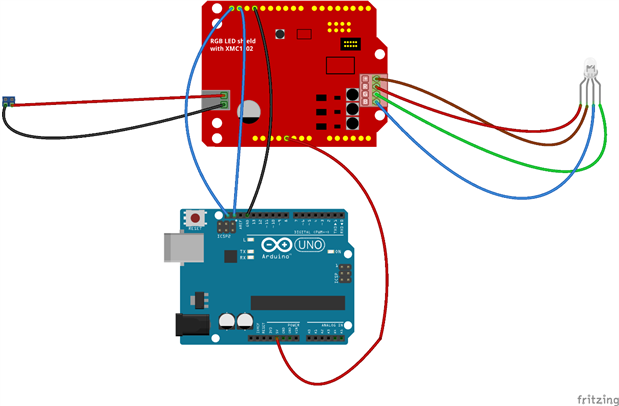

The Infineon RGB shield was easy to use and the previous challengers had generated some good documentation and code libraries. I knew I'd be right on the lower current limits of the board but with the right settings and timings the current was set correctly.

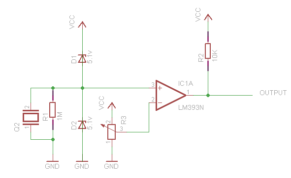

The knock knock circuit was heavily researched before incorporating into the project. The circuit was straight forward to understand and build with just the lack of a pull up resistor on the comparator output causing any delay.

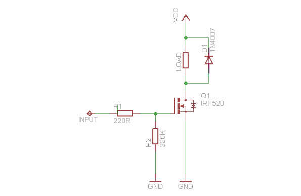

I've learnt a few bits of electronics along the way such as driving MOSFETS and handling the signal from the Piezo transducer and I've learnt lots about the Arduino Yún.

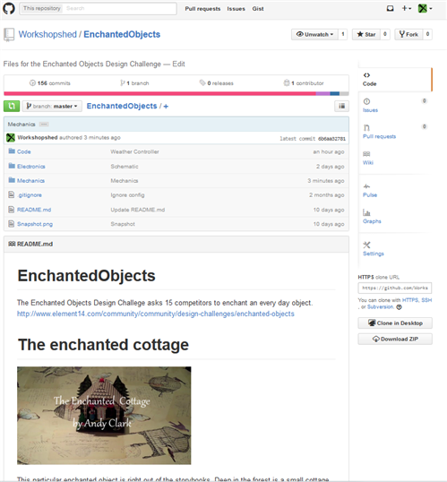

Circuit Diagrams, 3D Models and Code
All of the files for the project can be found on GitHub which I've been using all through the project to manage the project and share files between computers.
https://github.com/Workshopshed/EnchantedObjects
Code: https://github.com/Workshopshed/EnchantedObjects/tree/master/Code
The code is a combination of C++ on the Arduino side and Python on the Linino side, there are also some shell scripts to help setting up the system. The decision to use C++ classes to segregate the functionality was not done to create re-usable libraries for others but to make the code clear to read and maintain. The decision to use Python was based on that it was an easy language for beginners and that it was already installed on the Yún.
As mentioned above there are several libraries incorporated into the code
AdaFruit - DHT22 library - https://github.com/adafruit/DHT-sensor-library
Michael Anthony Schwager - Enable Interrupts Library - https://github.com/GreyGnome/EnableInterrupt
Michael Margolis,Philip van Allen and Korman - Variable speed Servo Library - https://github.com/netlabtoolkit/VarSpeedServo
Inderpreet Singh and Robert Peter Oakes - Infineon RGB lighting Library - https://github.com/inderpreet/infineonrgb_shield
Eberhard Fahle - configuring the handshaking line for the Arduino Yún
Electronics: https://github.com/Workshopshed/EnchantedObjects/tree/master/Electronics

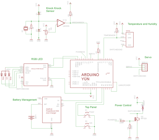

The original plan was to use Fritizing to document a lot of the circuits. Fritzing provided it's own challenges so a mini tutorial was written on what was learnt. As the project progressed many of the schematics were simply done using Visio as all that was needed was the high level blocks and wires. For the full schematic Eagle was used as it's libraries were more extensive so fewer components needed to be designed.
Many data sheets and websites were referenced and are too plentiful to mention here but they are mentioned on the specific posts that utilised them as a reference section.
{gallery:width=500,height=500} Circuit Diagrams
Power Switch: Switches on an off the peripherals
Knock Knock: Sensor circuit

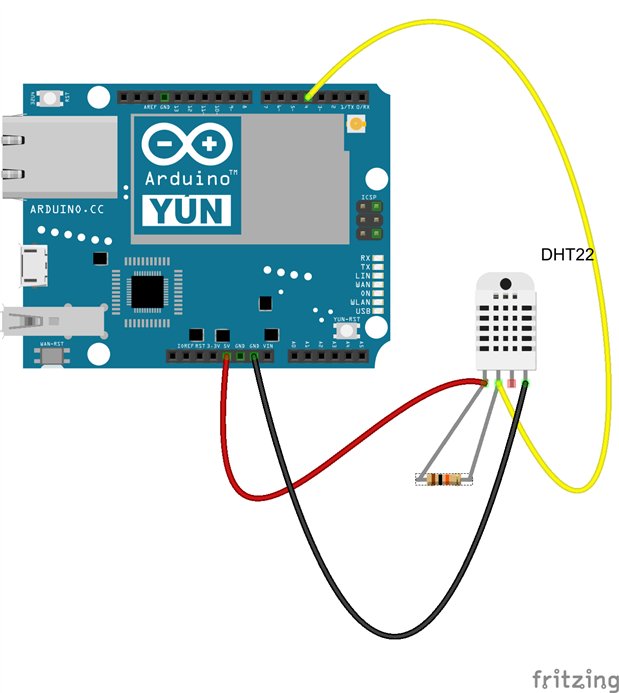

DHT22: Temperature and Humidity Sensor
RGB: Infineon RGB Shield and LED
Schematic: Full schematic

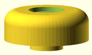

Mechanics: https://github.com/Workshopshed/EnchantedObjects/tree/master/Mechanics

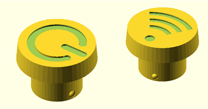

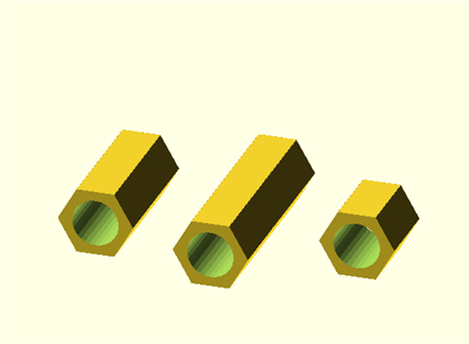

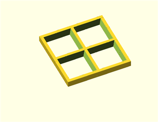

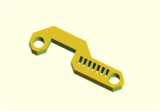

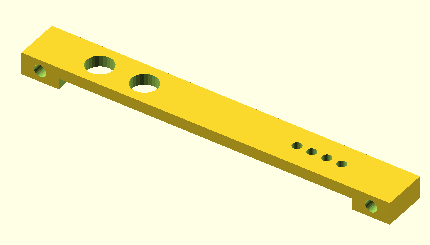

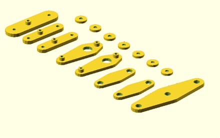

The 3D printed parts were all modelled in OpenSCAD so they have a source code as well as the STL files that were generated for printing.
{gallery:width=500,height=500} Printed Parts
Mechanism: Parts for the Watts Linkage
Magnet Housing: Holder for the magnets
Fibre Housing: Attach fibre optics to the Arduino Yún
Window: Replacement window
Top Panel: Show fibre status and buttons
Buttons: A couple of buttons to control the setup
Spacers: Different heights of spacers for the boards

    Updated the schematic with nice labels. Thanks again balearicdynamics
    balearicdynamics over 11 years ago in reply to Workshopshed
    Thank you to raise the question Andy. Just for me only I have always ignored this. Asap I will update my circuits too, and next ... will be better !!!
