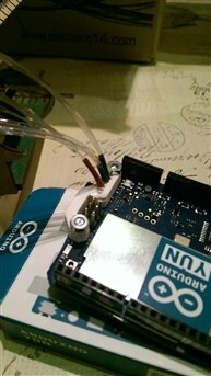

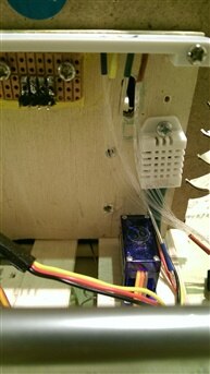

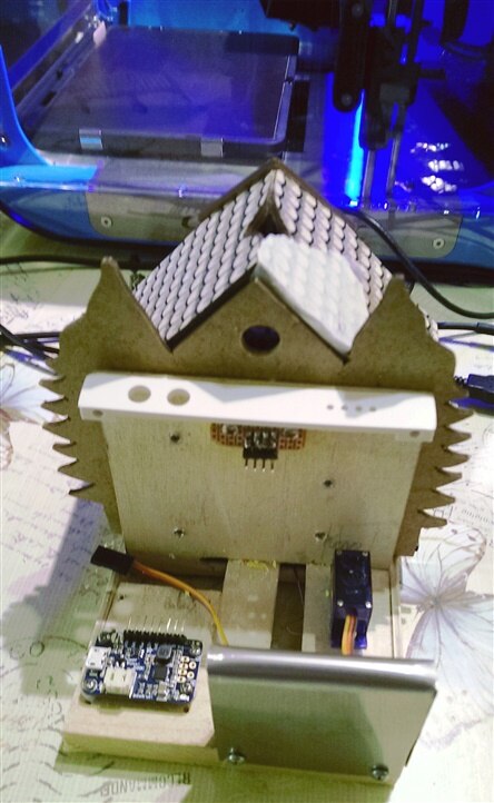

Matilda realised that this idea of total internal reflection was also how fibre optics works, she wondered if these could be used to extend the LEDs that were deep in the heart of the electronics to the top of the house for display. Some fibres were purchased and Matilda played with bundles of these wrapped in tape to ensure that the light would transmit as desired.

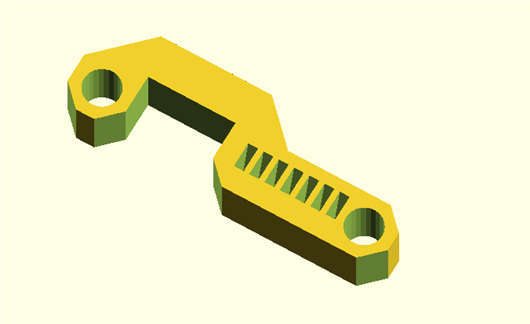

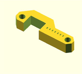

She designed a part to fit over the LEDs on the Arduino Yún with slots to take fibres from the LEDs

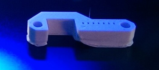

The first version of this was printed and had a couple of issues. One of the corners badly distorted where the adhesion to the bed was poor, the second was that the holes were too small so installing the fibres would be challenging. An additional check showed that the holes for the support struts were a bit small so these were increased from 3.2mm to 3.7mm.

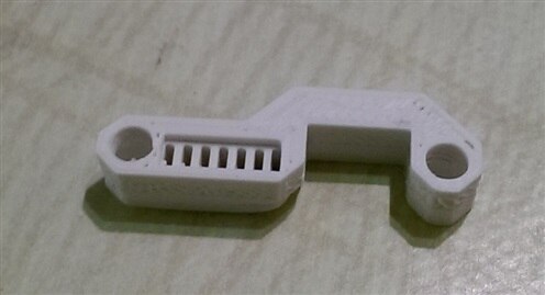

The new model resolved these issues with bigger slots for fibres, bigger holes and the sharp corners were chopped off.
That fixed the problems and the new part printed without issue.

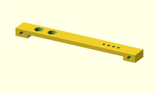

A top panel for a couple of switches and 4 lights was also designed, the POWER, WIFI, LED 13 and USB LEDs are to be extended to the panel as all of these can be controlled by our code / hardware.
Testing the fibres
0.5mm fibres were used so that they could be in a straight line for the rectangular LEDs but in a circle on the top panel.
The fibre housing and top panel work well but the fibres are quite slippy (and have a low melting point) so the heat shrink tubing used to indicate the colours and hold the fibres together is not locking them in place. Some kind of adhesive will need to be added, I suspect Sugru will do the trick.

    Workshopshed over 11 years ago in reply to mcb1
    I found some Bondloc B2012, will give that a go.
