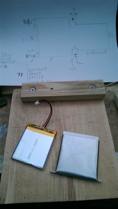

Referring to Engineering Workshop Practice 1956 volume III, we can see that the neutral plane for a bend lies 20% of the way through the sheet. Everything on the inside of that will be under compression and everything on the outside will be under tension. We can use this to calculate an allowance for bending.
The formula for calculating an allowance for bending when the measurements are on the outside of a joint are as follows:
L= A + B - (2 * 0.8)T
if the measurements are made on the inside of the joint then it's
L= C + D + (2 * 0.2)T
Based on this Matilda sketched a design for the battery box that could be folded out of the metal the golem had cut for them.

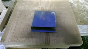

A box was built based on the sketch and above calculations and the battery fitted perfectly. However, the cable was too short to reach the power board.

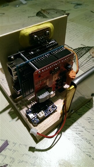

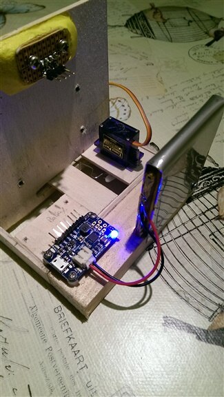

So a redesign was needed, the side was taken off and it was re-drilled.
The rear basement had already been extended to allow for the size of the stack of Arduino and shields. The charging circuit and boosting circuit was moved slightly and the battery and cable now both fitted. The main board was fitted to ensure that there was clearance for all the connectors and that the battery could be removed without needing to disassemble the boards.

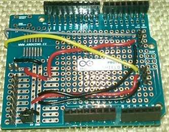

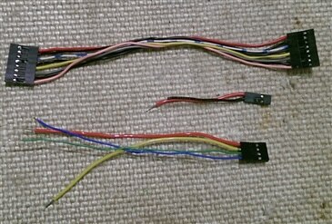

Some of the cabling was also started with some cables for the LED power and LED made up and a cable for the power also soldered up. The protoshield was wired up with headers for the servo and power supply, for the cables that were undecided they work left long and wrapped over the side of the board. A space was left in the middle of the board for a power mosfet to turn on and off the servo and lighting board.

    I was using 0.5mm stainless steel so I just bent it by hand over a piece of wood. Bending tools are not particularly expensive if you are doing small parts, there is one that fits over the vice jaws and…

    I was using 0.5mm stainless steel so I just bent it by hand over a piece of wood. Bending tools are not particularly expensive if you are doing small parts, there is one that fits over the vice jaws and forms good 90° angles.
    Also have a look on homemadetools.net there are plenty of examples of tools you can make.

    Yes, having a tool rather than doing it by hand does generate a better result in that case.
    mcb1 over 11 years ago in reply to Workshopshed
    Nice work Andy.
    One quick and easy tool if you are bending just the lugs, is an adjustable spanner.
    I have also clamped down the flat part of the sheet, and bent the other bit up or down to suit
    A piece of wood and hammer can help 'tighten' the bend if it's not going to plan.
