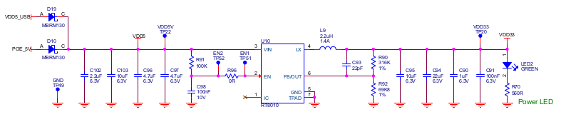

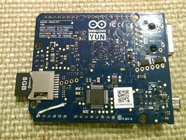

A discussion on the Arduino forum lead to a part of the schematic that controlled the 3.3v regulator. The RT8010 regulator has a two test points TP51 and TP52 (bridged by a 0ohm resistor). The author kindly points out where those test points are located as there's no silk screen indicating which are which. As per the example the corner I/O pin was used, A5.
Retrospectively they remembered that the A5 pin is shared with the I2C bus on the Uno, luckily this is not the case for the Yún.
The software control for this is pretty straight forward too, it can be controlled as a digital pin. You'd want to wait until any writing to disk was complete before powering off so that will need to be factored into the software. Using that control the consumption drops to 30mA.

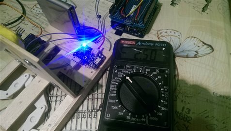

The multimeter uses a different socket for currents over 200mA so a cable swap and photo was taken to get a more accurate reading of the lowest current. For the powerDown the Watchdog timer is used and hence Timer0 which is used for Millis() is turned off and Timer1, used by the Servo() library is also off. This will affect the flashing/colour cycling of the LED and servo so that needs to be factored in the the code.
This brings the power down to 2.5mA, approx 80th of the original power required or 33 days of runtime from the battery. Obviously the bursts of activity will bring this down but a week's run time seems achievable.

    You can see it in the lower picture, all the lights are off on the Yún. I'm measuring the current after the power board so that super bright blue LED isn't included in the measurement, so that would be…

    The eagle files in the link above aren't actually eagle files. One you pointed out the inductor (for whatever reason I missed it, should probably stop working on this for today) I was able to figure out the orientation of the chip next to it. From there it is a matter of some fine soldering which I will be taking up tomorrow. I will let you know how it goes.

    Looking at the schematic for the https://store.arduino.cc/arduino-industrial-101 I can see that the regulator but it does not come with the same test points
    However, on link above there is a download for the PCB designs in Eagle so if you can work out where R37 is then you could potentially tap into that or even off the regulator chip, obviously it's a lot harder to solder to that and you'd risk frying the regulator.  I'd expect it to be somewhere near the top left of the board where there 2R2 is marked on the inductor.
