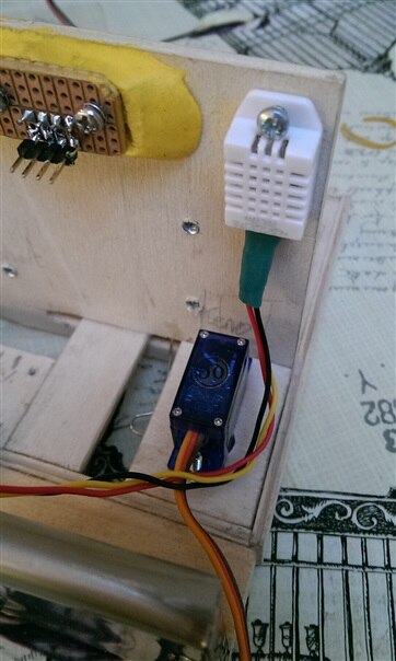

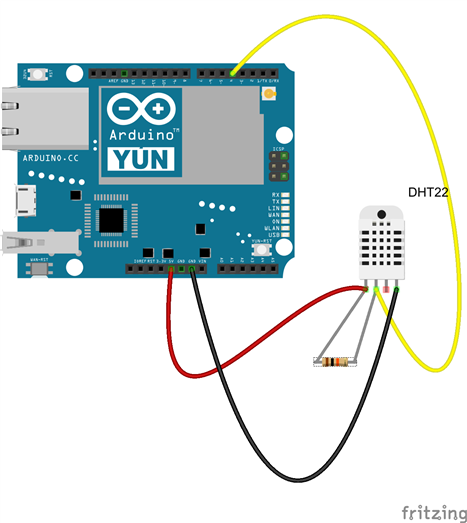

"We are going to have to do it the old fashioned way", said Hans. "Not the cat gut?!" cried Matilda. "Not quite that far back" he said. Hans rummaged in his spares box and brought out a tiny device that looked a bit like a cheese grater. "We can get the local temperature and humidity with this DHT22 and estimate the chance of precipitation from that" said Hans.

#include "DHT.h"
#define DHTPIN 4     // what pin we're connected to
#define DHTTYPE DHT22   // DHT 22  (AM2302)
// Connect pin 1 (on the left) of the sensor to +5V
// NOTE: If using a board with 3.3V logic like an Arduino Due connect pin 1
// to 3.3V instead of 5V!
// Connect pin 2 of the sensor to whatever your DHTPIN is
// Connect pin 4 (on the right) of the sensor to GROUND
// Connect a 10K resistor from pin 2 (data) to pin 1 (power) of the sensor
// Initialize DHT sensor for normal 16mhz Arduino
DHT dht(DHTPIN, DHTTYPE);
// NOTE: For working with a faster chip, like an Arduino Due or Teensy, you
// might need to increase the threshold for cycle counts considered a 1 or 0.
// You can do this by passing a 3rd parameter for this threshold.  It's a bit
// of fiddling to find the right value, but in general the faster the CPU the
// higher the value.  The default for a 16mhz AVR is a value of 6.  For an
// Arduino Due that runs at 84mhz a value of 30 works.
// Example to initialize DHT sensor for Arduino Due:
//DHT dht(DHTPIN, DHTTYPE, 30);
void setup() {
  Serial.begin(9600);
  Serial.println("DHTxx test!");
  dht.begin();
void loop() {
  // Wait a few seconds between measurements.
  delay(2000);
  // Reading temperature or humidity takes about 250 milliseconds!
  // Sensor readings may also be up to 2 seconds 'old' (its a very slow sensor)
  float h = dht.readHumidity();
  // Read temperature as Celsius
  float t = dht.readTemperature();
  // Check if any reads failed and exit early (to try again).
  if (isnan(h) || isnan(t)) {
    Serial.println("Failed to read from DHT sensor!");
    return;
  Serial.print("Humidity: ");
  Serial.print(h);
  Serial.print(" %\t");
  Serial.print("Temperature: ");
  Serial.print(t);
  Serial.print(" *C ");
  Serial.println("");
Hans decided to pass the local temperature and humidity over to the Python script and if there is no network or an error it can still return a position reference for them. That way all the weather related algorithms are in one place. Hans could not find any algorithms that connected humidity to precipitation but he thought if he based it around the dew point that would give a very similar result to the old cat gut.
