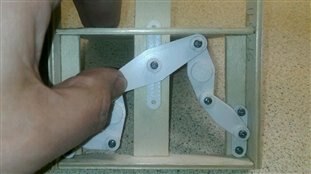

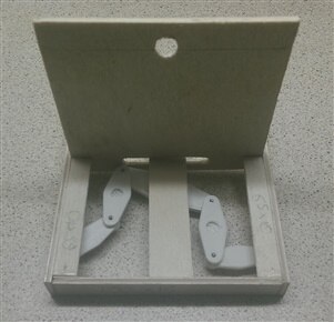

Hans and the woodcutter assembled the planks to form support frame for Matilda's mechanics. The woodcutter liked the minimalism of the wooden design, "everything should be made as simple as possible, but not simpler" he said before returning to the forest.
Hans and Matilda cleaned up the parts from the Blacksmith and polished the axles before putting them together with the screws. They checked that everything ran smoothly, some minor changes would be needed but the mechanism provided the motion that was desired.

To make the testing easier Matilda mounted the servos on a simple wooden test platform. Following the woodcutter's hint she connected these up to the test mechanism using bendy connecting rods.
