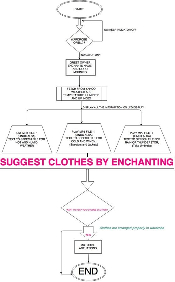

Here's a flowchart explaining the complete working on Enchanted Wardrobe:image
I am bit conscious about the suggest clothes feature, Based on temperature and weather conditions outside the wardrobe needed to be suggest clothing for the day to the user and now if user wants to go by the suggestion he can press the button and accordingly the cloth section will come ahead.! say if its a bright sunny day and wardrobe suggests to wear cotton clothes put shades and uv protection cream and if user agrees then the cotton clothes sections should come ahead if user agrees to the suggestion and presses the button, for this the sections should be divided properly in the wardrobe and a motorized mechanism needs to be made. GOOD IDEA to use motor shield but how is the question, SUGGESTIONS ARE WELCOMED image.
For Enchanting the suggestions in sound I'll save pre-made MP3 files in root of OPEN-WRT yun os and can envoke them to play within arduino code. I am gonna buy a usb based sound card tomorrow and i wish ALSA(Advanced Linux Sound Architecture) drivers works for me.

    balearicdynamics over 11 years ago in reply to iayanpahwa +1
    If I don't remember wrong, there is one of these systems to the laundry near home. If it maybe helpful I'll check if they leave me make some details photos. Enrico

    Looks like you have a plan, now all you need is to bound your project with a couple of prototypes.
    You cannot go wrong with a wind breaker design or camera vest.  Both are useful year around and have applications for adding technology.
    Take a look at Barbara's Hoodie posts.  You can get some good ideas from her.
