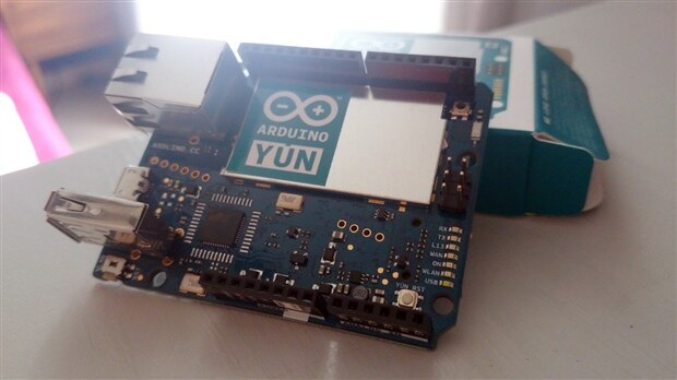

I Just received Arduino Yun.
There was some delay due to Greek customs,  as it was send from the US,  but element14 took care of it, along with the expenses
Thanks! :-)

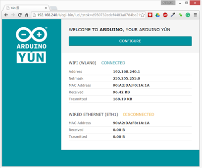

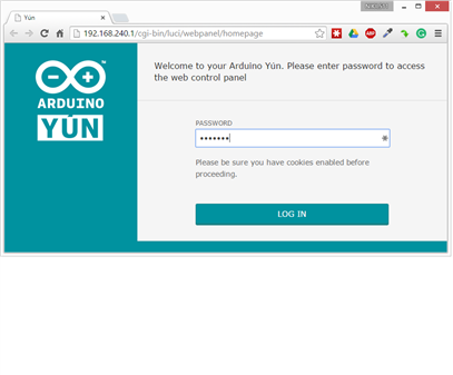

So I power up YUN with a micro usb cable, and search for wifi. Found one named "Arduino YUN blahblahxxxxx", connected and tried surfing it on IP 192.168.240.1
And this is the welcome screen. (password is arduino)

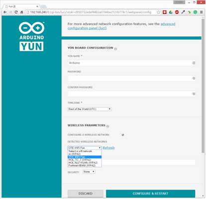

I configured my Wifi SSID and pass, (would be usefull to have a tick-box for displaying pasword)
rebooted and I can see Yun on my accesspoint, getting an IP, great!

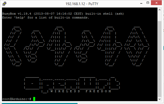

Did an ssh connection via putty, using root and arduino as pass, and here is the linino.
