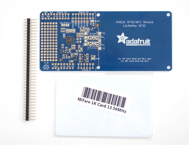

I have ordered one 125 kHz reader and key fobs and a NFC / RFID Arduino shield to try the most promising solutions.

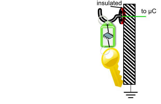

Wired solutions are often simpler and cheaper than wireless ones, but are less practical or convenient. My first idea to detect keys hanging on a hook was using switch which gets pressed or released by the weight of the keys. The detection part is really simple, more difficult is the identification. This has to be outsourced to the user: The hooks and key rings are marked with a colour and users have to hang their key on the respective hook. That violates my idea of how the user interface should be but would be a solution if everything else fails. (see explicit identification)

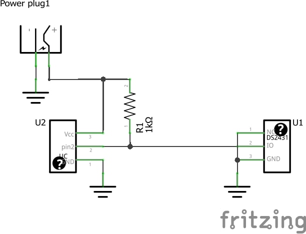

Since there is only one conductor between a key fob and the board 1-Wire devices came into my mind. Usually a circuit for 1-Wire looks like this:
But 1-Wire bus is a marketing lie: they do not count the ground wire!

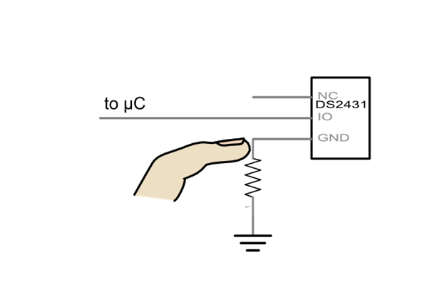

The question now is where do we get the ground from?
I have two ideas which I have to test. First use the human body as ground. The mass should be big enough for the small charge which has to be transported (ca. 7 nano coulomb). The resistance of the skin can be several kilo Ohms which may be too much. Since I am not an electronics expert and everybody I’ve so far asked could not answer this question I have to try it. Parts are ordered, stay tuned for updates.
While testing it turned out that the human skin is a very bad conductor which makes this version impossible at least with 3,3 V.

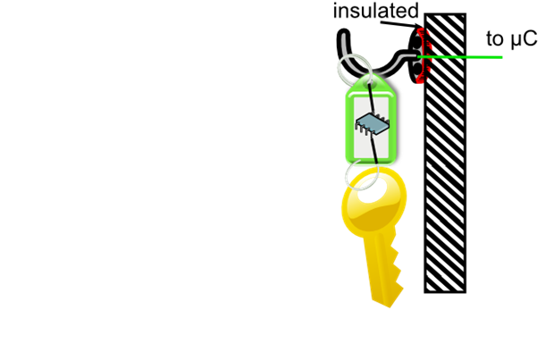

Since this does not work I would insulate the hook form the board and use the board as ground. Not as elegant but should work.
And indeed the keys are good enough conductors and when they are large enough they touch the board. So I have a solution!
