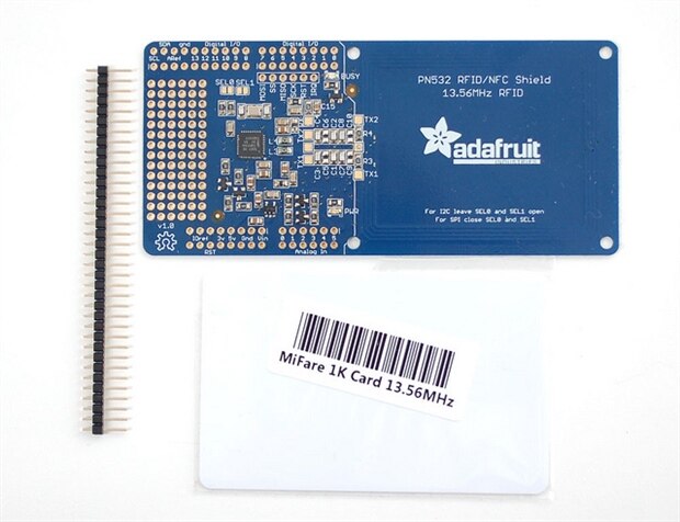

NFC and contact less Smart Cards use the same frequencies. 13.5 MHz readers and tags are easily available and cheap. UHF readers are very expensive so despite their good properties they will be excluded. 2.4 GHz passive tokens seem to exist only in theory. Therefore the choice boils down to two alternatives 125 kHz and 13.5 MHz which will be tested for their ability to communicate when the tag hangs between the keys. The metal may shield the tag and reliable reading might not be possible.
I have ordered one 125 kHz reader and key fobs and a NFC / RFID Arduino shield to try the most promising solutions.

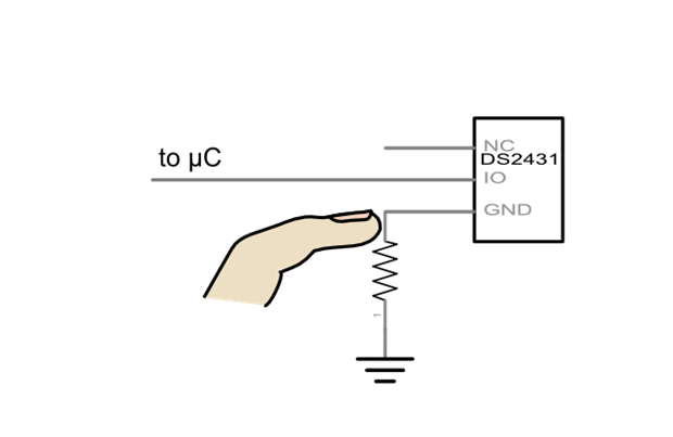

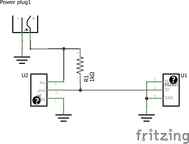

Since there is only one conductor between a key fob and the board 1-Wire devices came into my mind. Usually a circuit for 1-Wire looks like this:
But 1-Wire bus is a marketing lie: they do not count the ground wire!
The question now is where do we get the ground from?

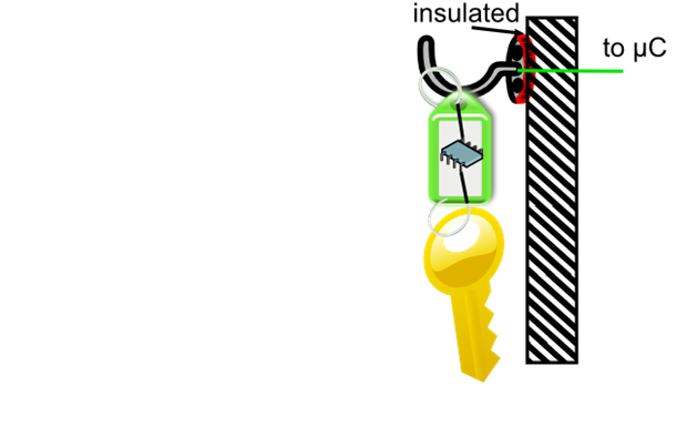

I have two ideas which I have to test. First use the human body as ground. The mass should be big enough for the small charge which has to be transported (ca. 7 nano coulomb). The resistance of the skin can be several kilo Ohms which may be too much. Since I am not an electronics expert and everybody I’ve so far asked could not answer this question I have to try it. Parts are ordered, stay tuned for updates.
While testing it turned out that the human skin is a very bad conductor which makes this version impossible at least with 3,3 V.

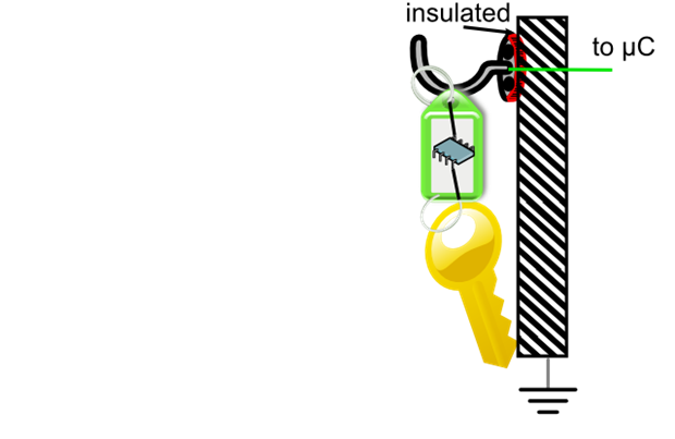

Since this does not work I would insulate the hook form the board and use the board as ground. Not as elegant but should work.
And indeed the keys are good enough conductors and when they are large enough they touch the board. So I have a solution!
