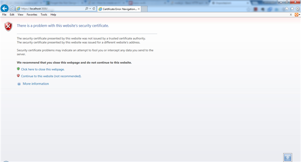

With  all these changes in place, we can now connect to the MagicHat web interface using HTTPS. Since the certificate is self-signed and not by a trusted certification authority, web browser will complain about that and will warn you about potential risks

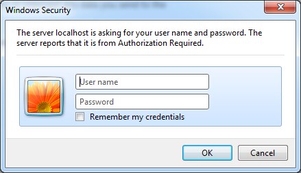

By clicking on the"Continue to this website" link, you will be asked for username and password
