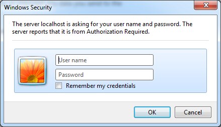

For this reason, I will implement HTTPS communication between the web browser and NodeJS running on Arduino Yun. Since the communication is now encrypted, we can use basic authentication (were password is just Base64 coded, but not encrypted)

Install NodeJS's basic authentication module
Since a  lot of the middleware was pulled out of the Express core in v4 and put into separate modules, the basic auth module needs to be explicitely installed
npm install basic-auth-connect
Implement basic authentication in node
var basicAuth = require('basic-auth-connect');
// NEW CODE BEGINS HERE
// replace 'user' and 'pass' with your username and password
app.use(basicAuth('user', 'pass'));
//NEWCODE ENDS HERE
app.use(express.static(__dirname));
app.use(express.static('.'));

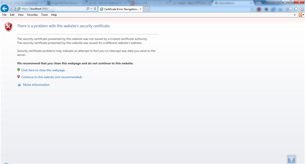

The only change required on the client side Javascript is to changes the websocket URL from ws://<ipaddress> to wss://<ip address> to use Secure web sockets. if standard web sockets are used, web browsers will raise a security error because you are trying to use an unsafe connection
With  all these changes in place, we can now connect to the MagicHat web interface using HTTPS. Since the certificate is self-signed and not by a trusted certification authority, web browser will complain about that and will warn you about potential risks
By clicking on the"Continue to this website" link, you will be asked for username and password

    amgalbu over 11 years ago in reply to Workshopshed +2
    Hi Andy I agree with you, but it's a bit too expensive to request certificate to a certification authority like verisign. The cost of "trusted certificate" is in the order of a couple thousand dollars…
  • crjeder
    crjeder over 11 years ago in reply to crjeder +2
    Yes, self signed certificates are for testing. Full Stop! They should never ever be on public sites!

    Workshopshed over 11 years ago +1
    Self signed certificates are great for prototyping secure systems, the only concern is that people get blind towards accepting the warnings if they are used too much. There's probably a good way to distribute…
  • Workshopshed
    Self signed certificates are great for prototyping secure systems, the only concern is that people get blind towards accepting the warnings if they are used too much. There's probably a good way to distribute keys internally around an organisation but I am not familiar with the techniques.
