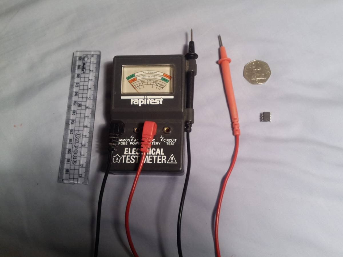

Solution: Repurpose an old analogue rapiest multimeter to display the number of messages in my inbox via the voltage indicator.
/\ fig 1 This is the meter I want to use, along with some objects for scale

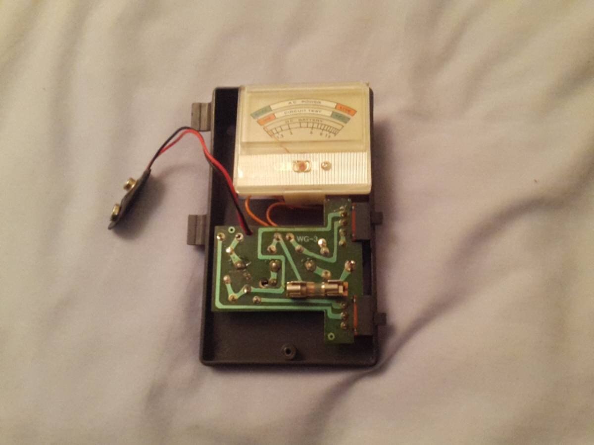

/\ fig 2 And here we have a photo of the meters circuitry

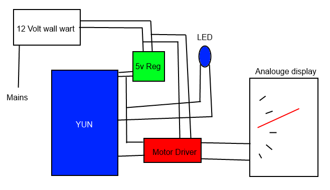

Hardware Design: The idea is to drive the display using a motor driver board and PWM. Conveniently the meter has a range of about 12 volts so a standard DC wall wart should be fine for powering this This does mean that the device can't display more than 12 messages, but hopefully I will check in regularly enough for this not to be an issue. Any values greater than 12 can easily just be have to be displayed as 12, or alternatively by a needle alternating between 0 and 12. The wall wart could also power the main board of the unit via a voltage regulator. For the main board I intend to use an Arduino Yun. The meter will conveniently operate on DC voltage mode with no power source so powering it will not be an issue. It also features 2 convenient side mounted switches that can easily be used to turn the unit on and off. It may also be worth adding an LED backlight to the unit that can be driven by the Yun and turned off with the other switch.
/\ fig 3 A quick visual overview of the hardware. Note that for simplicity, some passive components and the switches and the circuitry from the multimeter have been ommited.
Software design: The first stage of software will run on the Linux half of the Yun. Using Python it will regularly load and parse my inbox to find the message count. this will then be passed on to the ATmega. The mega will compare the value it receives to a table of PWM values and then use this to power the motor driver and move the needle to the correct position, or possibly between positions in the case of more than 12 posts, but this will be handled as a special case. The Yun can also drive the backlight with PWM, potentially allowing for either a heartbeat effect or a brightness increasing with message count.

    I think you'll find it doesn't actually require 12v on the meter itself to drive it fullscale.
    One clue is that it used a 9v battery to drive the continuity to fullscale, but apart from some automotive type meters, most are a low current meter across a resistor.
    I'd suggest tracing the circuit out and then you'll know what you're dealing with, and can adjust how you drive it.
    It will still work using your PWM technique.

    Thank you for your reply. I was thinking of driving it via the built in circuitry in voltage mode, but I may try and test without to see if I can omit the motor driver and instead drive directly from one of the pins. If I can do this then I may the LED driver shield for a more interesting back light.

    I strongly suggest using a high value resistor in series during your testing.
    I've seen someone bend the needle, and damage the coil.
    You might be able to stick the meter across 12v and measure what the meter leads show to get an idea.
    Good luck I like the interface to analogue.
  • kidiccurus
    kidiccurus over 11 years ago in reply to mcb1
    Thanks for the advice, I have already done some testing and have concluded that a resistor is needed. My next blog post may take a little while due to the problems with my PC, but I will try and get it up in the next few days.
