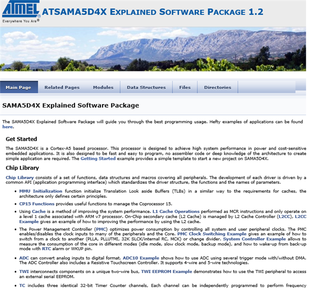

I downloaded the library and example sources from SAMA5D4 Software Package. There's an archive there with the name SAMA5D4 GNU Software Package 1.2 for Xplained board.
There are 3 sections in the package:
  • documentation
  • library sources
  • application sources
The documentation folders describe the libraries and the example applications. There's also an additional text document there that describes how to port the examples to Eclipse.

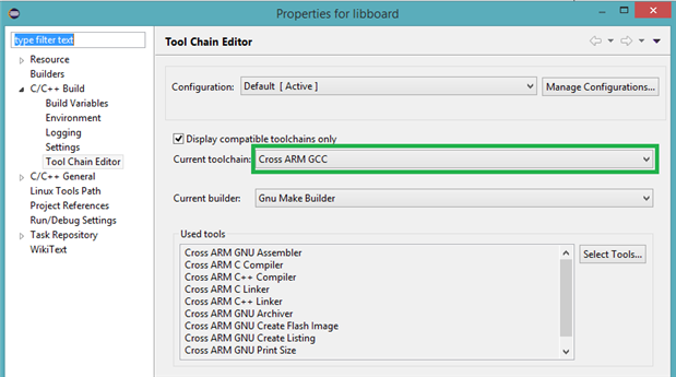

I've installed GNU Tools for ARM Embedded Processors (version 4.9 2015q1). I used the Windows installer and accepted all defaults.
I followed the install instructions from GNU ARM Eclipse. The install menu contains good info. I paid proper attention to what options to switch off in the installation programs.

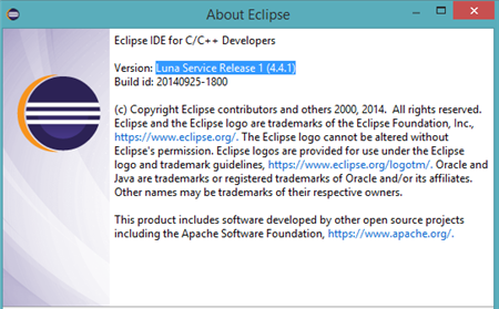

I reuse the Eclipse Luna edition that is running on my PC (Luna Service Release 1 (4.4.1)).
The tool chain is available in Eclipse straight away if you follow the instructions from GNU ARM Eclipse.

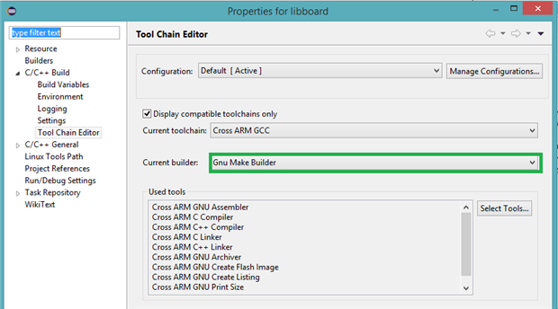

Again following the instructions from GNU ARM Eclipse, you install the  GNU Tools for ARM Embedded Processors.
If done right the build tool chain is available in Eclipse.
This would be a good test again to see if you can build a library.

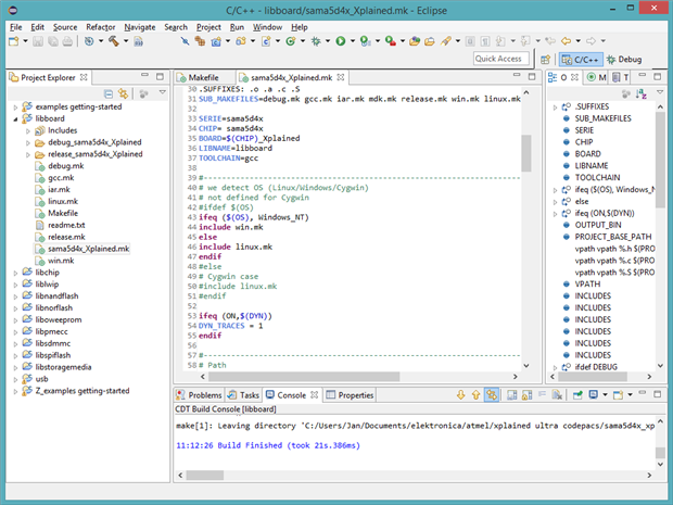

With this setup, I could successfully build all libraries from source.
I haven't been able to build one of the examples and load it to the board. That's something for a next post.
