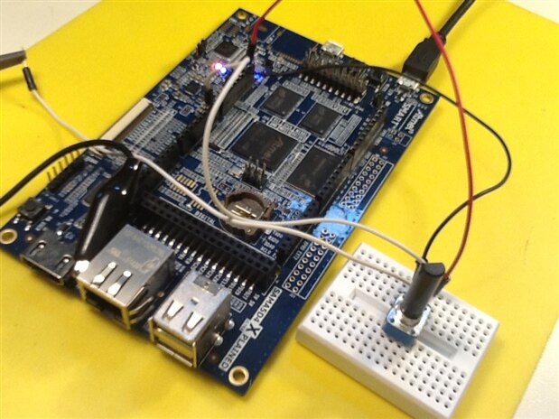

I've spent two months investigating the board, the available information, and the look and feel of the community around it.
First a bit of background on my skills: I know electronics, microcontrollers and processors, have unix/linux, rtos  and C++ experience, can program several ARM flavors. Know build systems, IDEs and tool chains
I have no prior experience with developing for high performance embedded systems like this SAMA5D4.
I have difficulties getting started with datasheets only. I need working examples and how-to guides to step on the learning curve. I have difficulties getting started if I don't have a working example that I can refer to.
All further comments have to be seen with that background in mind.

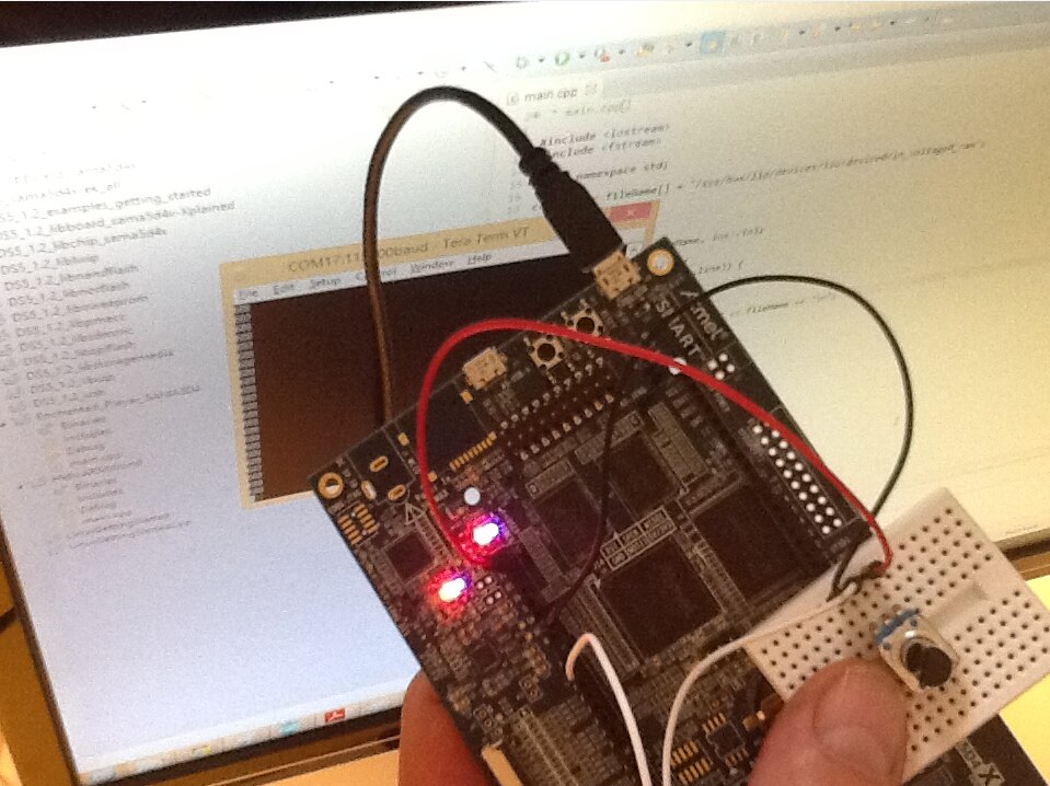

I have a hard time to explain how difficult it was for me to get a tool chain set up, examples compiled, and get them loaded and executed on the board.
In hindsight, all I did was already documented on the web. Nothing I did successfully hasn't been done by someone else before. But the Getting Started documents and links do their very best to send you astray.
Google doesn't help the starter either. It returns results, but it takes an experienced eye to filter wrong advice from right advice. My calendar tiched more than 60 days before I was capable of seeing that difference.
My computer has approximately 1GB of needlessly installed software and non-working examples.

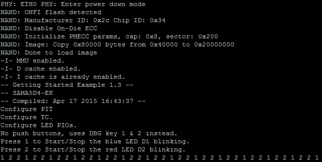

Similarly, I was not able to load and run the bare metal examples that are posted on the Atmel SAMA5D4 landing page on my own.
An ascii readme with instructions from source to 'running the executable on the board' would have taken less than 2 KB. It's doable. Someone on the support forum explained it to me in 8 steps;

It's a great processor, and a board with loads of possibilities. Loads of options. Nice PCB design. Very high quality.
Never ever have I experienced a bug. And as electronics aficionado, I stand in awe when I hold it it my hands.
Should you use the SAMA5D4:?  Yes, definitely it is an ARM that lives up to its specs, and it sports great peripherals.
Should you use the Xplained Ultra board? Yes, if you already have skills in this segment or if you are very stubborn. No if this is your entry point to learn embedded linux.
It's a great development kit, and it would excel in its segment if the public training materials would guide you to a repeatable path to wisdom.
