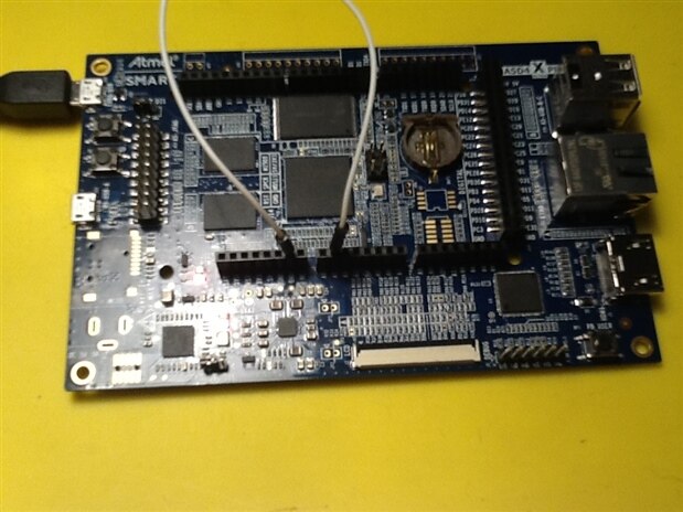

My first run is with the analog input connected to ground. I'm doing the exercise while writing the blog, so what you see here is exactly as it happens.

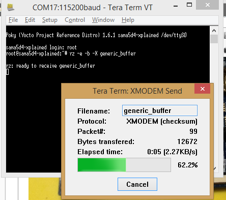

As a first step, I load my compiled program
rz -e -b -X generic_buffer
chmod +x generic_buffer

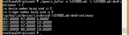

And now the moment suprême: running that binary:
# Don't use at91_adc when working with a 'device tree' linux distro ./generic_buffer -n at91_adc -t fc034000.adc-dev0-continuous -l 2
./generic_buffer -n fc034000.adc -t fc034000.adc-dev0-continuous -l 2

update May 22:
Solved. The error was caused by 2 things:
(see element14 question SAMA5D4 ADC driver - do you know a Linux image that has the driver?)
1. the source for generic_buffer.c :
There's a multitude of versions of that file on the internet.
Here's the correct one: https://raw.githubusercontent.com/linux4sam/linux-at91/master/drivers/staging/iio/Documentation/generic_buffer.c
In the correct one, here's how the device is found:
dev_num = find_type_by_name(device_name, "iio:device");
In the wrong one:
dev_num = find_type_by_name(device_name, "device");
2. With the switch of the Yocto distro to device tree, the name of driver/trigger changed.
This is reflected on http://www.at91.com/linux4sam/bin/view/Linux4SAM/IioAdcDriver
echo "fc034000.adc-dev0-continuous" > /sys/bus/iio/devices/iio:device0/trigger/current_trigger

    Steady progress.
    Here's an image of a 2kHz input signal sampled with the buffer method (48 data points):
