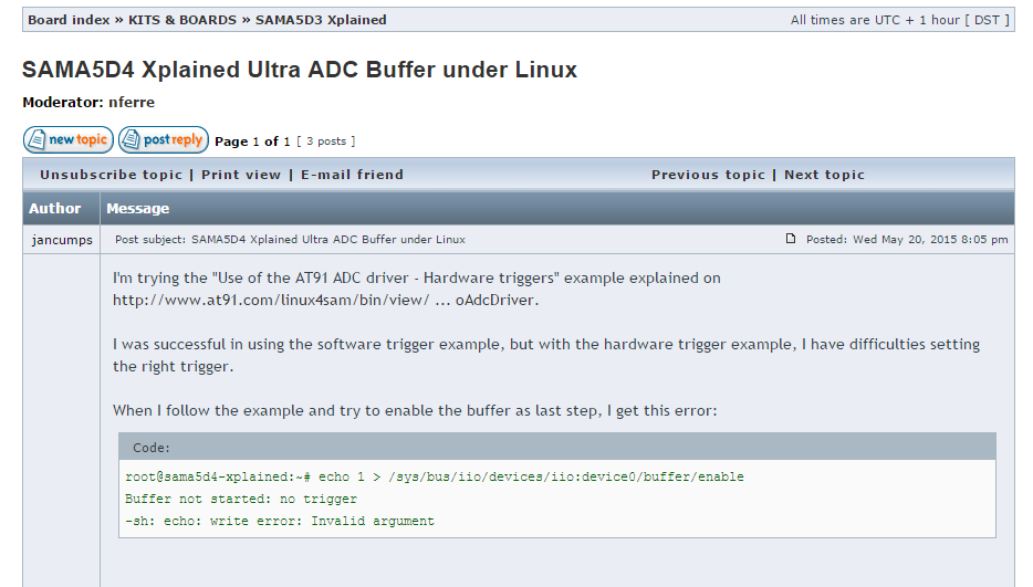

I'm trying the Buffer and Hardware Trigger  capabilities of the SAMA5D4.
I followed the instructions on IioAdcDriver < Linux4SAM < TWiki, but was struggling with one particular command.
I raised a topic on tha at91.com forum. And resolved it myself.
Sometimes writing down your problem leads to the solution.
Instructible
You can read my topic on the at91 site to see where I was in trouble.  (jc: At the time of posting this blog, I didn't know yet that I would get the at91.com treatment)
In this blog, I'll post the how-to.

How did I get the magic name "fc034000.adc-dev0-continuous"? It's different than the name "at91_adc-dev0-external" used in the AT91.com instructions.
By fiddling around a lot, and then by submitting the command
root@sama5d4-xplained:/sys/bus/iio/devices/trigger0# cat name
