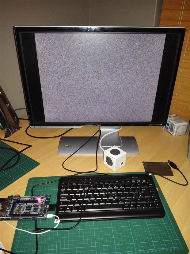

Over the weekend just gone by I managed to create an Ubuntu boot disk and get the SAMA5D4 running with an operating system that provides me with
features I am a little more used to vs the Poky build that Atmel provide.
What I built was Ubuntu 14.04.1 LTS compiled and running on the SAMA5D4 Xplained Ultra board. Along with supporting root file system.
Thankfully this include apt-get and I have been able to install all my favourite tools, including a GCC compiler tool chain directly to the
board.  I really enjoying developing directly on single board computers so this is pretty useful for me.

You don't necessarily need to use the hdmi device tree, but it will add the framebuffer to /dev for you, which means you can tinker
with getting the HDMI screen running. I admit I have had it working, but not as a console display its not easily plumbed into place like on a Raspberry Pi.
I managed to draw a lot of colourful pixels to it using the command cat /dev/urandom > /dev/fb0
I found I needed to sometimes plug and unplug the HDMI cable to make it recognize the monitor was there.

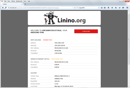

    The Yun would not boot with the half installed OS, the "press a button for 30s" trick to reinstall the default did not work either, I'm guessing that those buttons are soft keys. So using the Arduino - YunSerialTerminal script and this warranty voiding process Arduino - YunUBootReflash I got it back and operational again, I'm currently running with a Linino version so get a friendly robot on my admin screen rather than Arduino Logo.
    If I have time I'll be looking at the boot process in more detail as I'd like to get the boot time down from 41s. I'm hoping to be able to turn off that part of the board and restart it periodically to check the weather before shutting it down again. There seems to be some big pauses in the boot sequence. The idea is to run it all from batteries and have the board sleeping most of the time.
    I'm also wondering if I can customise the default admin page but again that's at the end of my challenge when everything else is working correctly.

    [    2.940000] usbcore: registered new interface driver ushc
    [    2.940000] TCP cubic registered
    [    2.950000] NET: Registered protocol family 17
    [    2.950000] Bridge firewalling registered
    [    2.950000] 8021q: 802.1Q VLAN Support v1.8
    [    2.960000] VFS: Mounted root (squashfs filesystem) readonly on device 31:2.
    [    2.960000] Freeing unused kernel memory: 180k freed
    [    3.260000] usb 1-1: new high-speed USB device number 2 using ehci-platform
    [    3.460000] usb 1-1: New USB device found, idVendor=058f, idProduct=6254
    [    3.460000] usb 1-1: New USB device strings: Mfr=0, Product=1, SerialNumber=0
    [    3.470000] usb 1-1: Product: USB2.0Hub
    [    3.550000] hub 1-1:1.0: USB hub found
    [    3.550000] hub 1-1:1.0: 4 ports detected
    [    3.990000] usb 1-1.4: new high-speed USB device number 3 using ehci-platform
    [    4.130000] usb 1-1.4: New USB device found, idVendor=058f, idProduct=6366
    [    4.130000] usb 1-1.4: New USB device strings: Mfr=1, Product=2, SerialNumber=3
    [    4.130000] usb 1-1.4: Product: Mass Storage Device
    [    4.140000] usb 1-1.4: Manufacturer: Generic
    [    4.140000] usb 1-1.4: SerialNumber: 058F0O1111B1
    [    4.210000] scsi0 : usb-storage 1-1.4:1.0
    [    5.020000] Error: Driver 'gpio-keys-polled' is already registered, aborting...
    [    5.210000] scsi 0:0:0:0: Direct-Access     Multi    Flash Reader     1.00 PQ: 0 ANSI: 0
    - preinit -
    Press the [f] key and hit [enter] to enter failsafe mode
    - regular preinit -
    [    9.570000] JFFS2 notice: (526) jffs2_build_xattr_subsystem: complete building xattr subsystem, 1 of xdatum (0 unchecked, 0 orphan) and 11 of xref (0 dead, 0 orphan) found.
    [   11.270000] sd 0:0:0:0: [sda] 15122432 512-byte logical blocks: (7.74 GB/7.21 GiB)
    [   11.270000] sd 0:0:0:0: [sda] Write Protect is off
    [   11.280000] sd 0:0:0:0: [sda] No Caching mode page present
    [   11.280000] sd 0:0:0:0: [sda] Assuming drive cache: write through
    [   11.290000] sd 0:0:0:0: [sda] No Caching mode page present
    [   11.290000] sd 0:0:0:0: [sda] Assuming drive cache: write through
    [   11.290000]  sda: sda1
    [   11.300000] sd 0:0:0:0: [sda] No Caching mode page present
    [   11.300000] sd 0:0:0:0: [sda] Assuming drive cache: write through
    [   11.300000] sd 0:0:0:0: [sda] Attached SCSI removable disk
    switching to jffs2
    - init -
    Please press Enter to activate this console. [   38.580000] Loading modules backported from Linux version master-2014-05-22-0-gf2032ea
    [   38.580000] Backport generated by backports.git backports-20140320-37-g5c33da0
    [   38.760000] cfg80211: Calling CRDA to update world regulatory domain
    [   38.760000] cfg80211: World regulatory domain updated:
    [   38.760000] cfg80211:  DFS Master region: unset
    [   38.760000] cfg80211:   (start_freq - end_freq @ bandwidth), (max_antenna_gain, max_eirp), (dfs_cac_time)
    [   38.770000] cfg80211:   (2402000 KHz - 2472000 KHz @ 40000 KHz), (N/A, 2000 mBm), (N/A)
    [   38.770000] cfg80211:   (2457000 KHz - 2482000 KHz @ 40000 KHz), (N/A, 2000 mBm), (N/A)
    [   38.770000] cfg80211:   (2474000 KHz - 2494000 KHz @ 20000 KHz), (N/A, 2000 mBm), (N/A)
    [   38.780000] cfg80211:   (5170000 KHz - 5250000 KHz @ 80000 KHz), (N/A, 2000 mBm), (N/A)
    [   38.780000] cfg80211:   (5735000 KHz - 5835000 KHz @ 80000 KHz), (N/A, 2000 mBm), (N/A)
    [   38.780000] cfg80211:   (57240000 KHz - 63720000 KHz @ 2160000 KHz), (N/A, 0 mBm), (N/A)
    [   39.750000] ieee80211 phy0: Atheros AR9330 Rev:1 mem=0xb8100000, irq=2
    [   39.750000] cfg80211: Calling CRDA for country: US
    [   39.750000] cfg80211: Regulatory domain changed to country: US
    [   39.760000] cfg80211:  DFS Master region: FCC
    [   39.760000] cfg80211:   (start_freq - end_freq @ bandwidth), (max_antenna_gain, max_eirp), (dfs_cac_time)
    [   39.760000] cfg80211:   (2402000 KHz - 2472000 KHz @ 40000 KHz), (N/A, 3000 mBm), (N/A)
    [   39.770000] cfg80211:   (5170000 KHz - 5250000 KHz @ 80000 KHz), (N/A, 1700 mBm), (N/A)
    [   39.770000] cfg80211:   (5250000 KHz - 5330000 KHz @ 80000 KHz), (N/A, 2300 mBm), (0 s)
    [   39.770000] cfg80211:   (5735000 KHz - 5835000 KHz @ 80000 KHz), (N/A, 3000 mBm), (N/A)
    [   39.780000] cfg80211:   (57240000 KHz - 63720000 KHz @ 2160000 KHz), (N/A, 4000 mBm), (N/A)
    [   40.200000] NTFS driver 2.1.30 [Flags: R/O MODULE].
    [   40.250000] Error: Driver 'gpio-keys-polled' is already registered, aborting...
    [   40.270000] loop: module loaded
    [   40.410000] PPP generic driver version 2.4.2
    [   40.460000] ip_tables: (C) 2000-2006 Netfilter Core Team
    [   40.580000] NET: Registered protocol family 24
    [   40.610000] nf_conntrack version 0.5.0 (954 buckets, 3816 max)
    [   41.060000] i2c /dev entries driver
    [   41.100000] Linux video capture interface: v2.00
    [   41.220000] fuse init (API version 7.18)
