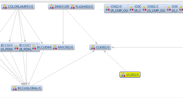

The steps 2, 3, 5 and 6 are covered in a tutorial by infineon and step 4 was suprisingly easy:
In the App view select the I2C003 APP:

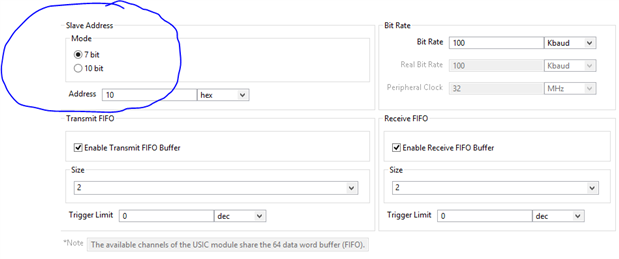

Then right-click on it and select UIEditor. In UIEditor make the necessary changes:
Then compile and download to the board.
