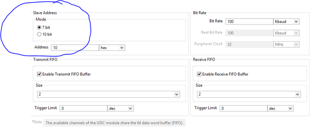

Firmware Modification
Since Infineon provides the source of the firmware of the RGB Shield I can try to change it to use 7-bit addresses.
My first attemt would be to simply modify the address to something 7-bit compatible. Steps to do are:

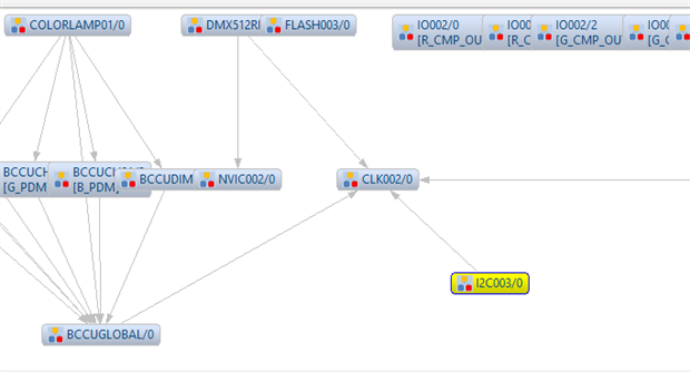

The steps 2, 3, 5 and 6 are covered in a tutorial by infineon and step 4 was suprisingly easy:
In the App view select the I2C003 APP:
Then right-click on it and select UIEditor. In UIEditor make the necessary changes:
Then compile and download to the board.
