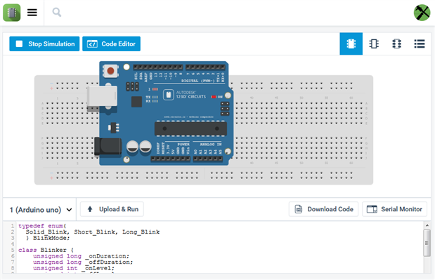

When I was making the Topsy Turvy Clock I created a non blocking delay class so that the Arduino could be doing other things whilst waiting for a timeout. This avoids the use of the delay function which otherwise "blocks" the operation until the timeout is completed. I realised that this same technique could be used to control the flashing of the RGB LED. This will need to be expanded to handle the colour cycling which will indicate that the Wifi settings need configuring.
Code: https://github.com/Workshopshed/EnchantedObjects/tree/master/Code/Examples/Blinker
Example Usage
Here's an example of the blinking code using the LED on pin 13.
#include "Blink.h"
Blinker b(1,0);
void setup() {
  b.Blink(Short_Blink);
  pinMode(13, OUTPUT);
void loop() {
  digitalWrite(13, b.Level());
  //Do other things here as desired
Virtual Prototyping
As an experiment the code was uploaded to 123D circuits.
https://123d.circuits.io/circuits/868830-blinker-class
This allowed the example to be tested from a web page without the need for actually having an Arduino plugged into the computer.

    mcb1 over 11 years ago +1
    Why didn't you just do it in the code, rather than add the extra library.? The example "BlinkwithoutDelay" (yes stupid name) uses the same millis Timer as you've used. I've always advacated for avoiding…
    I've always advacated for avoiding using Delay whenever possible.
  • Workshopshed
    Workshopshed over 11 years ago in reply to mcb1
    I've been reading a little about the GCC compiler, it does have the built in option of inlining functions that it knows are safe to do so. So is there a reason why I'd go for a in-line function rather than a class based approach?
    As an aside, I swapped out a few variables with smaller data types e.g. my servo angle is constrained between 50 and 100 degrees so I can fit that into a uint8_t rather than an int. That saved be about 60 bytes. Dropping the Process.h library saves me about 3400 bytes although I still need to write the code to send the message to Serial1, although I'm optimistic that I'll be able to write my bit in less than that.
    I also tried an experiment adding an unused function (with quite a few instructions), that only added 6 bytes to the total so I'd guess that the compiler is doing some optimisations there.
