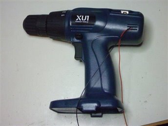

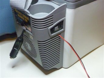

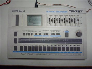

In my articles I will include details of odd locations and devices where I have harvested energy.
Where possible I will be using existing items and technologies in the quest for environmental sustainability and minimal impact.
And like usual I will retain the original functionality of the items.

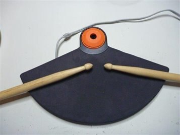

Can anyone pick the odd picture out?

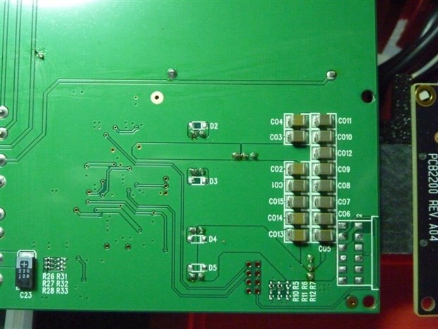

    The Energy Harvesting board is designed to give the developer the option of harnessing multiple energies simultaneously.
    This can be done by the removal of the circuit selection jumper and the installation of diodes on the backside of PCB.
    If you look at my picture of the energy storage bank you can see the component overlay and pads for these optional diodes marked D2 through D5.
    Cheers

    Nice to see you back again. I guess crawl, walk run is a very good strategy... I always start with running, but that gets very tiring in the end image
    To pick the odd one out: I guess it's the drum pad because it doesn't have a red and black lead
