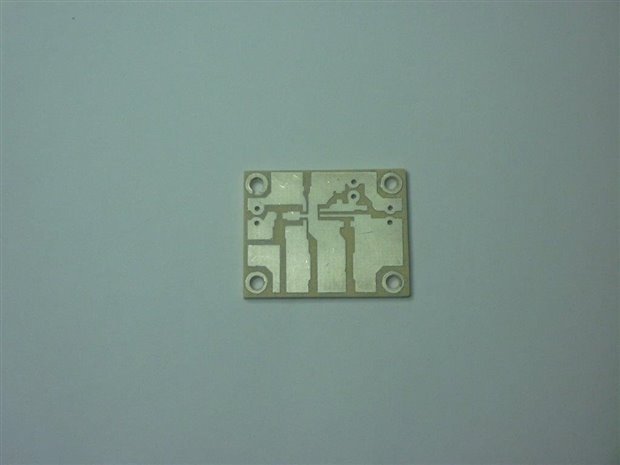

Just Milling about for a Tinny!
I've outline milled out a PCB for the LED Driver.
Here is the result.

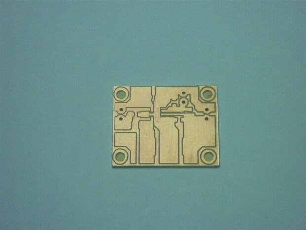

I then manually weeded out the unwanted copper with a scapel blade.
After this I then decided to plate the copper and make it silvery.
It now looks like a bought one.
I also have the capability to apply a solder mask but since this is a prototype it wasn't necessary.
  • COMPACT
    COMPACT over 13 years ago in reply to DAB
    Thanks Don,
    I used a CNC machine to mill the outline of the PCB.
    Hand weeding of copper voids preserves my engraving bits and gives a very good result at the expense of my sanity.
    Cheers
    Very Compact
