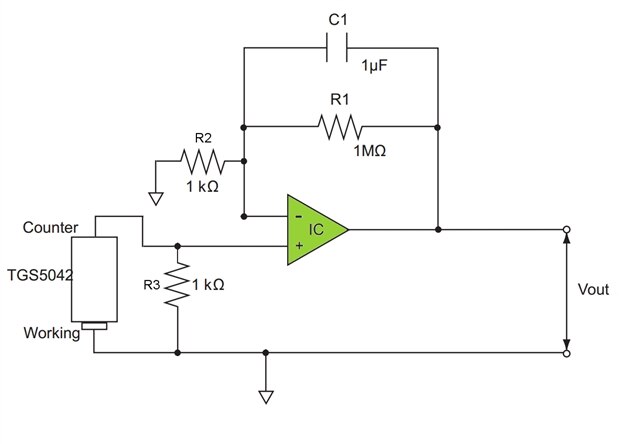

I have tested it and it works great, but … it requires external opamp with dual supply. With energy harvesting there is a problem with energy availability so with adding additional charge pump or other DC/DC (inverter) we would lose some vital energy. That is why I wanted to use the opamp which is already inside the EFM32 chip on the STK. The problem is that it is only single supply opamp. So, I propose another measurement circuit:
The 1k resistor next to the sensor is for protection purposes. The datasheet says that the sensor should not be polarized with voltages above +/-10mV (when storing the sensor, datasheet suggests to short-circuit it). While my circuit is operational, there would be no problem, but I plan to turn off everything that I can, whenever I can to save power. That is why I have included this 1k resistor to protect the sensor (even in a high carbon monoxide concentration) when the internal opamp is disabled. I have used the opamp in non-inverting configuration (cause there is only one power supply and I do not want to make any external circuits for virtual ground) and that is why I had to invert the sensor leads.
The sensor with STK is operational. The voltage to ppm conversion can be applied with the linear graph from the datasheet. The output voltage from the opamp takes form of: Vout = Isensor * R3 * ((R1 / R2) +1). It can be read with EFM32’s ADC.
The gain is about 106 with the circuit I propose, so the 3V single supply amp can detect concentration far above 1000 ppm which is more than sufficient for home appliences.

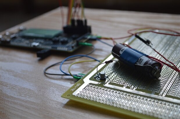

I have filmed a short sensor test video, but I need some time to convert and upload it, so right now I present only the picture of the setup. I will upload the video as soon as I find some time.

    Hello Gelmi!
    Nice post, good to look at the opamp feature of the EFM32, I haven't been able to explore that. However, I do have a slight warning for you; the open loop gain of the opamp is only 100dB, which is a factor 10^(100/20)  = 100000. You won't be able to get 10^6 gain out of that opamp. When these numbers are true (I'm a bit worried about the claim in the datasheet that the numbers are derived from simulations) you won't be able to get the full range of amplification you had wanted. With the high gain you ask, the bandwith also reduces considerably. I've made a very simple opamp model below with a 120 dB open loop gain and a pole at 60Hz, and you see that it takes quite a while to get to the desired output voltage.
    The other problem I see in this circuit and in the specs of the opamp is that the bias current of the opamp is not specified. Unfortunately, a lot of opamps with rail-to-rail inputs have an highly input-voltage dependant input bias current, which could mess up your measurement.
    I guess however that it is still possible to read out this sensor, but either with an external opamp with shutdown, or by measuring the current (first schematic in you post), but offsetting both the counter electrode and the '+' input of the opamp with an offset voltage from an DA converter.That will leave less room for amplification, but maybe you could do some oversampling?
    Interesting sensors!
    EDIT:
    On a second look, I noticed that you take the first 60dB gain by using the resistor as a current->voltage converter, and then use the opamp for another 60dB, which is very well possible with 100dB open loop gain. Which defeats my complete simulation above, but does stress the influence of the input bias current.
    EDIT2:
    I just realized that my calculation in the LTSpice screenshot is off; I had used 380rad/s for 60Hz, whereas it should be the timeconstant, so it had to be 1-over-380.....
