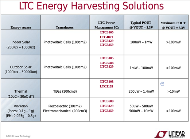

Before I received the energy harvesting kit, I had hoped to be able to use the piezo vibration to just use uneven roads and other vibration to generate enough energy. Unfortunately, piezo was not the solution. First, no piezo was included. Second: a small energy harvesting piezo already costs more than the fine you'd get from the police. Third: the amount of power I need greatly surpasses the amount of energy that's available from piezo harvesting. If you take a look at this slide from the presentation of Linear, you'll see that 30cm2 of piezo would give me 500μW. I need about 100 times more: 2V, 20mA -> 40mW. No go.
But wait; electromagnetic might yield > 10mW!
Energy harvesting - Bike light on Electromagnetic? Maybe.
