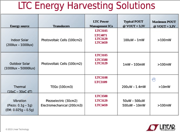

Before I received the energy harvesting kit, I had hoped to be able to use the piezo vibration to just use uneven roads and other vibration to generate enough energy. Unfortunately, piezo was not the solution. First, no piezo was included. Second: a small energy harvesting piezo already costs more than the fine you'd get from the police. Third: the amount of power I need greatly surpasses the amount of energy that's available from piezo harvesting. If you take a look at this slide from the presentation of Linear, you'll see that 30cm2 of piezo would give me 500μW. I need about 100 times more: 2V, 20mA -> 40mW. No go.
But wait; electromagnetic might yield > 10mW!
Energy harvesting - Bike light on Electromagnetic? Maybe.

The first is the regular solution. You'll understand when you'll read the other option. I thought about how to use non-used energy in the bike to generate electricity. I still wanted to use the vibration of the bike to power the light. I thought about using some linear moving magnet inside a coil, suspending the magnet with two springs. Then I thought about using a speaker to work as generator. I'll have to use one of the Wurth transformers to generate a voltage high enough to get some energy. I did some preliminary testing, and found that it's quite hard to get continuous energy from this setup, and not energy in excess to store energy a long time.
