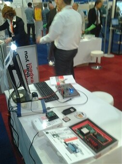

Trade fair:
First, a few very dodgy pictures; I went to the Electronics and Automation Trade Fair in Utrecht, and of course Wurth was also there. To my delight they had a table with both RoadTest Challenges: wireless power and Energy Harvesting; very nice to see. The other picture shows 'Energy Harvesting Development On-The-Go'. As I'm very productive while sitting in the train, I took my EnergyMicro board with me.
Trade show with Energy Harvesting, and debugging on the train
