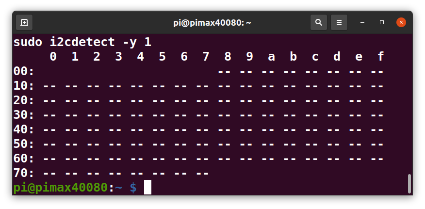

The screen shot is the command output with no devices detected. What gives everything is assembled and connected?
As misza pointed out in his blog post, the Current 6 Click board has a EN (enable) pin that helps determine the i2C address for the board. On the shield board it is labeld CS. I recall this being chip select from my legacy careers. The pin is controlled via a Raspberry Pi GPIO pin. For a C6C board in slot 1 of the Pi3CS board it is gpio 8 and in slot 2 it is gpio7.
The enable needs to be established on boot. A common method to configure a gpio on boot and have them permanent is to make changes to the /boot/config.txt
I found an explanation at this link to carry you through the weeds.
https://forums.raspberrypi.com/viewtopic.php?f=117&t=208748
If you just want the details. Add the following entry to the bottom of the config.txt file
[all]
#Set GPIO8 to be output set to 1
gpio=8=op,dh
If your C6C board is in slot 2 change the 8 to a 7.
After saving the changes reboot.
Now the output from the i2c-tools detect should show an device.

I observed some strange behaviour with the click board that I have not seen with other i2C type boards.
If you enable a gpio and use i2ctools to detect the board, then remove the gpio enable and reboot, the i2c-tools output slows to a craw, where as before the output appeared almost instantly. Only after you remove the C6C board does the i2ctool return to normal. It seems once the board is enabled it loads down the i2C bus even after the enable is removed.
I have little knowledge to know what is happening other than I notice the i2ctools not performing and wanted to see if it was something I was doing to cause it to happen.

    misaz over 4 years ago
