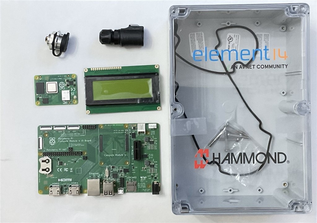

In the following composition, you can see an image showcasing all the components of the kit. Upon unpacking the components, I immediately noticed the size difference between the Raspberry Pi 4 compute module board, which was surprisingly small, and the IO board for the Raspberry Pi 4 compute module, which was notably large. Additionally, the display impressed me with its size, weight, and sturdy construction.
Element14 Experimenting with Extreme Environments Ki
I was expecting another additional circular connector as advertised in the list of kit components, although I had planned a use for that connector, it is not important for the project and can be substituted in the design.

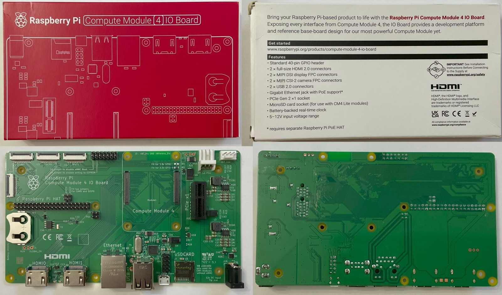

The smallest board is the Raspberry Pi4 Compute Module . This board is really small for all the potential it has. Nice design job by Raspberry. I was worried about the temperature the module can reach and I did some tests with a fan. The tests with the fan were satisfactory in terms of temperature regulation but not in terms of consumption. Although I did not measure the consumption with a fan, I did notice that the battery did not last as long as I would have liked. I have purchased an aluminum heatsink that works quite well, at least in the first tests.
The large board is the I/O board for the Raspberry Pi4 Compute Module. . I am going to use the I/O board during the development of the solution but for the final assembly I will use another simpler I/O module since my solution does not need as many interfaces and I need to reduce consumption.
This board can be powered through a 12 VDC barrel jacket or through a connector like the one used to power the PC power supplies that carry 5 and 12 VDC. If you are going to use the fan, it must be powered at 12 VDC.
There are two circular connectors: one for mounting on the box (MRD-BG04-L13-000 ), and one for a connector cable (MRD-BN04-M17-000 ). I will use the board connector to charge a battery, a 20000 mAh PowerBank, which will supply 5VDC to the Pi4 Compute Module and to the Display.
  • MRDBN04M17000 | Circular Harsh MRD Series | Amphenol (amphenol-cs.com)
  • MRDBG04L13000 | Circular Harsh MRD Series | Amphenol (amphenol-cs.com)
I could also use three of the pins to connect an external microphone but I will add a second circular connector with a TRS connector to facilitate the connection of different microphones during the experiments.

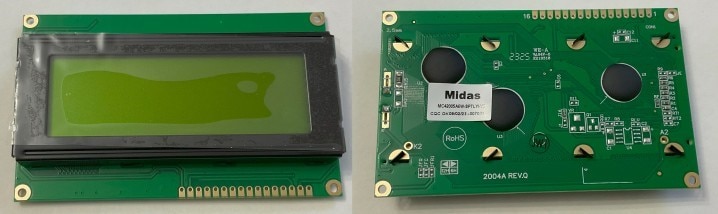

The display is a MIDAS backlit LCD display with 4 lines of 20 characters , it can display ASCII characters and 8 custom characters can be programmed. We will see in this blog how we can also use it to display graphical information in real time. I had trouble finding examples of display drivers that would work with this display, so in the end I decided to write my own lightweight driver. I present it later in this blog as well as the code repository so that anyone can use it however they want.
Also included in the kit is the Hammond enclosure  that comes in a configuration with a transparent polycarbonate lid, a rubber gasket to prevent the entry of water and four screws that remain fixed to the lid for maintenance work.

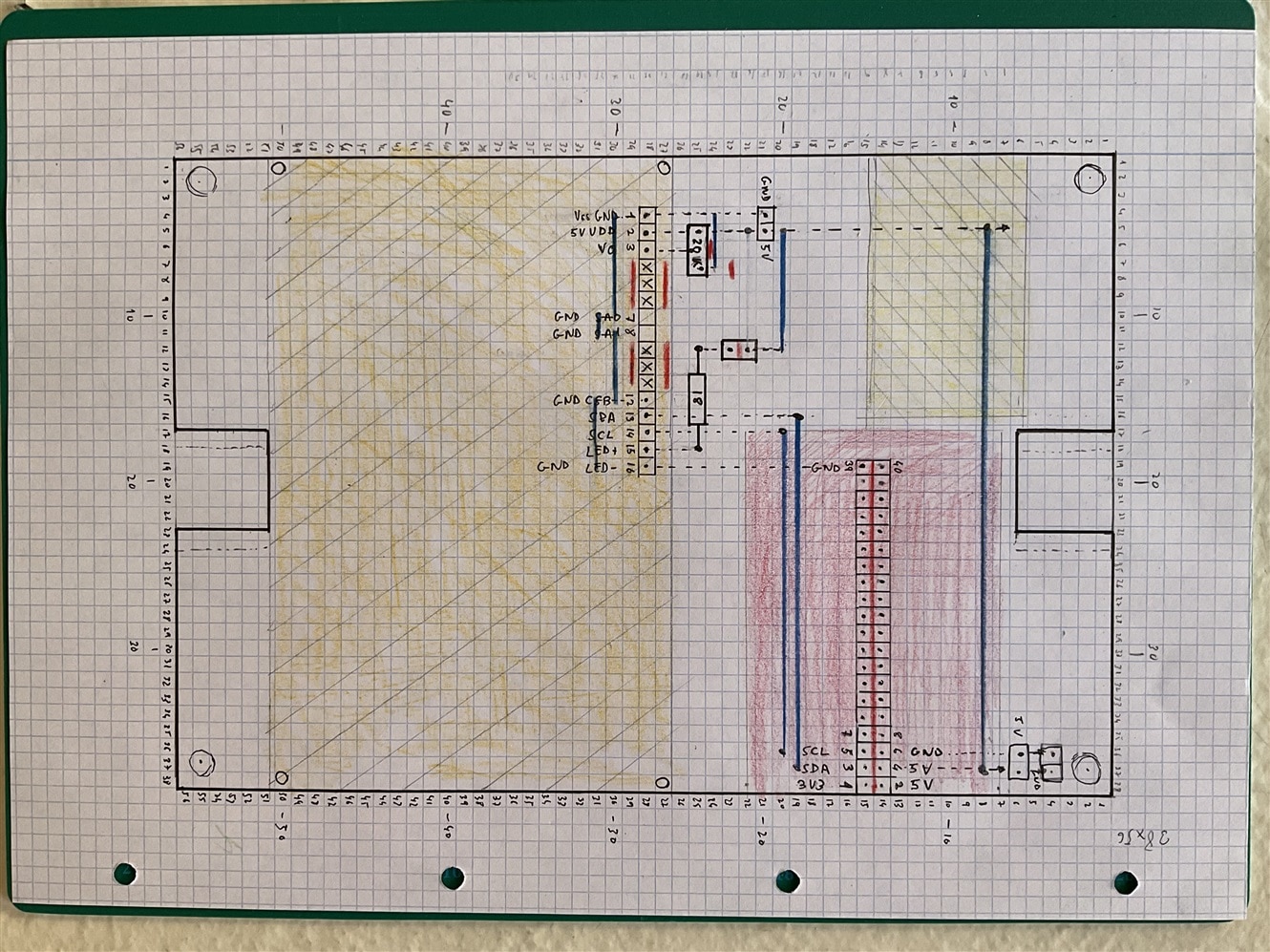

Considering the size of the battery I'll be using and to maximize available space, I've opted for a layered design approach. This involves organizing the components in layers within the enclosure to utilize space efficiently. The bottom layer will accommodate the largest and heaviest components, while the display will be positioned on the top layer.
To implement this design, I've cut a couple of transparent acrylic plastic panels for initial testing. Initially, I attempted to cut the acrylic using a manual fret saw, but the results were unsatisfactory as the saw blade tended to hook on the acrylic, causing tearing and breakage. Eventually, I switched to using a Dremel rotary tool  with a cutting disc for PVC , operating at 15,000 rpm and ensuring the cutting area was well lubricated with dishwashing detergent.
In the image, you can see the two panels prepared for testing along with the tool used for cutting. It's crucial to note the importance of wearing protective safety glasses when using tools like rotary tools or saws. Remember, you only have one pair of eyes, so protecting them is essential.
I've prepared this template for cutting in svg format:1554VAPL_innerpanel.zip

Midas Display
The MC42005A6W-SPTLYI-V2 is a 4×20 Character LCD display. It has a Black on Yellow/Green appearance, and its construction is Chip-on-board (COB). The interface is I2C and it has Eng / Jap font sets.
Uses the RockWorks  RW1063 LCD Controller. The RW1063 is a LCD driver & controller LSI which is fabricated by low power CMOS technology. It can display 2 lines x 8 (5 x 8 dot format) characters or 1 lines x 8 (5 x 8 or 5 x 11 dot format) characters. It is ideal for multi-language application.
Standard code RW1063-0A-001 can support up to 240 fonts.

    UrbanRest Guardian - Components Arrangement
    After seeing the elegant solution,  Blog 3 - Wildlife Monitor Project - Enclosure Modifications , that ralphjy  has come up with to arrange the elements of his project, I realized that in none of my iterations had I tried placing the box horizontally. So, I decided to give it a shot. I couldn't believe how much simpler everything became that way. In a short time, everything was well arranged and accessible, and there was plenty of space everywhere.
    In the image above, you can see my first attempt with the box placed horizontally. While it's not the definitive solution yet because I aim to take advantage of the side rails, as Ralphy does, and possibly position the display above instead of below.
    This development is good news for my project. However, the bad news is that today I injured my right hand at work, and I will be unable to exert efforts with that hand for a while. Fortunately, I'm not pressed for time with the project, so I'll take this opportunity to carefully review this solution on paper.
