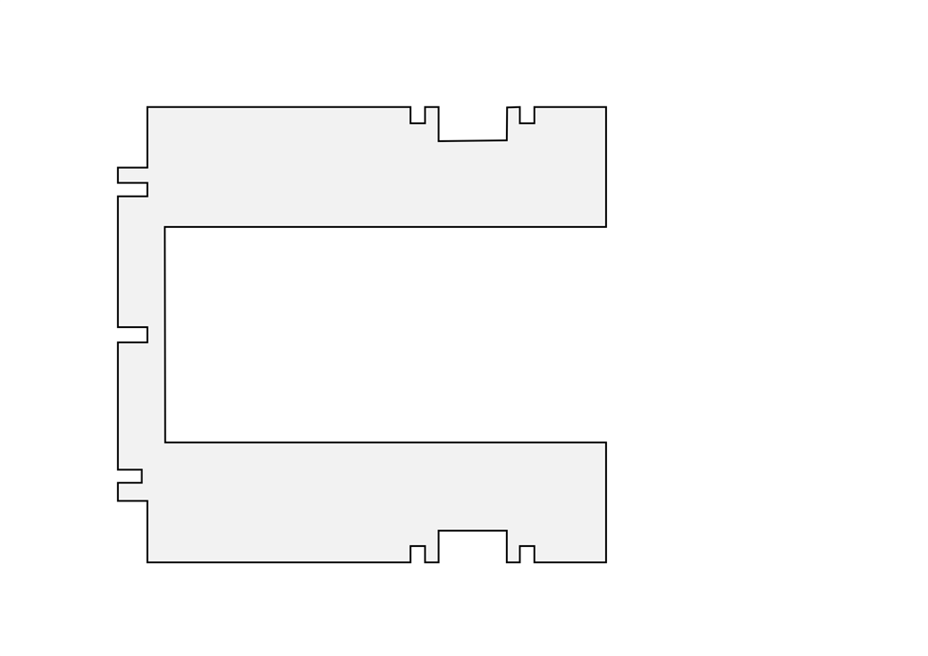

Designing the foam bed to house the battery
As shown in the photo of the test arrangement, the battery sits on a lower level at the base of the box, but there's nothing securing it in place.
UrbanRest Guardian enclosure arangement
I considered various options, like crafting a support from wood or acrylic plastic, or 3D printing a structure for the battery. However, due to an injury to my right hand that limits my ability to exert force with it, I thought of opting for a softer material. Discussing it with my family, we came up with the idea of making a foam bed for the battery.
Constructing the foam bed to house the battery
I had a foam sheets left over from the packaging of a small HDMI display. I designed the bed like a puzzle to maximize the use of the foam sheet.
Cutting the foam is extremely simple with a sharp blade or knife. In the image, I used a typical ham knife for slicing Iberian ham.
The foam bed rests on the inner panel made of acrylic plastic. It includes pass-through holes for the standoffs that will support the stripboard panel with the interconnected electronic devices. Additionally, it features cable guides at the bottom to help organize the wiring.
image image
Finally, a small panel that will be inserted into the PCB rails of the box will secure the battery on the side that remains free. The top part of the battery is secured by some standoffs at the bottom of the stripboard.
