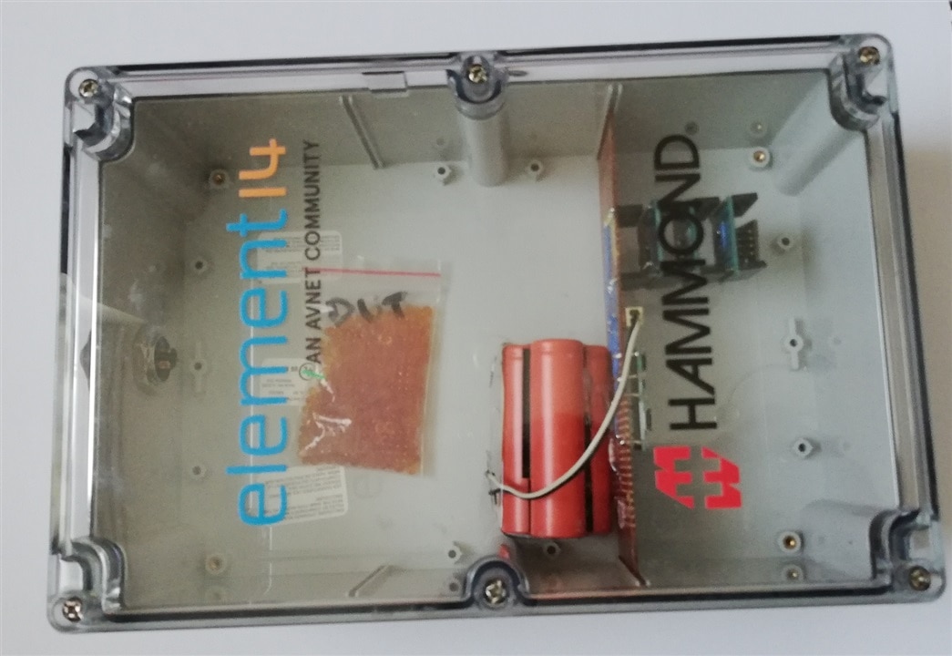

As I already had light grey enclosure (one of my Z74 boxes), black one was needed. I have obtained another waterproof box and fitted it with decommissioned ESP32 sensor left after  hardware unification.  Construction was rather makeshift, but it was meant only for one test, so I have decided that it would suffice:

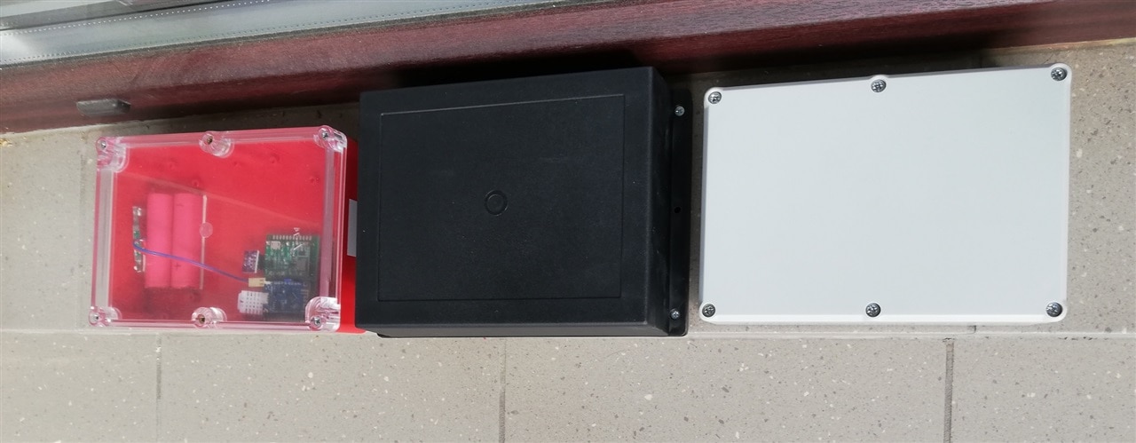

then some of the enclosures were located in the place where they could be subject to the direct Sun radiation
black vs. while

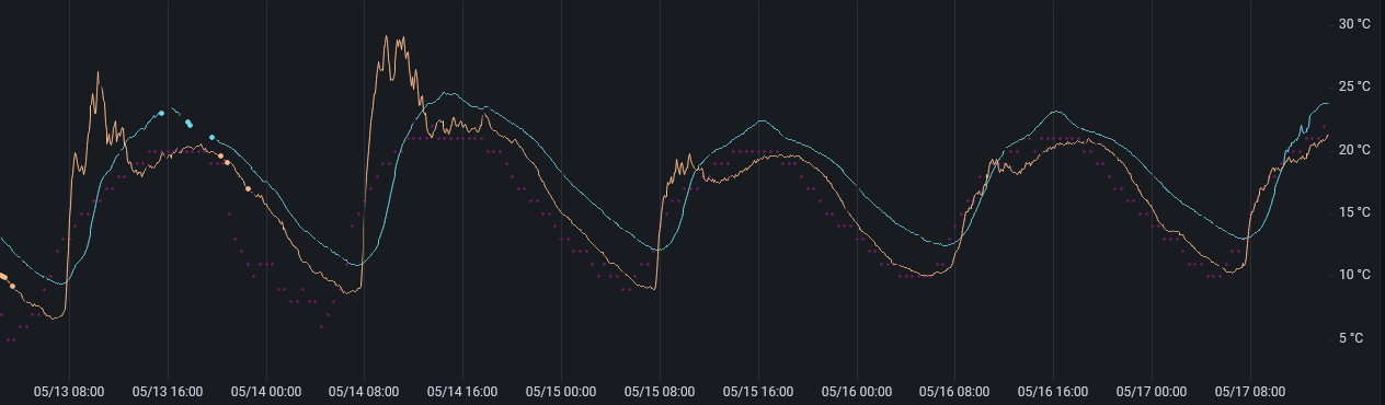

and testing began. First let's see external temperature variation (from METAR data [purple dots] and two local weather sensors)
baseline - two sensors
as we can see - nothing extreme (maximum temperature about 25°C) with one exception - where probably sensor got partially exposed to the sunlight.

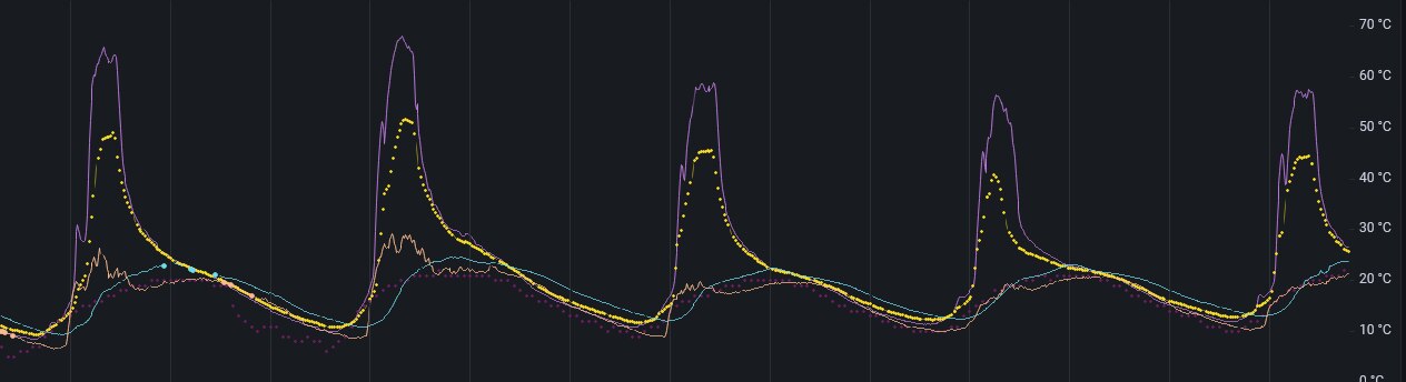

And how about our enclosures?
black vs white
as we can see - during direct sunlight, light grey enclosure internals (top yellow line) heated to max. 51.4°C, and black one (top purple line) to 67.6°C - more than 15°C hotter than a grey one and about 40°C hotter than external air temperature.

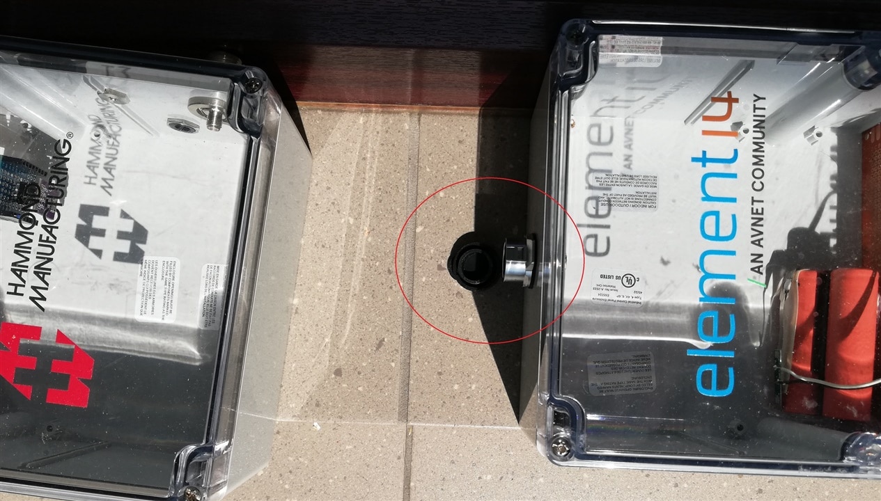

After the test series I have encountered something strange - waterproof connector installed in Hammond enclosure had it's protective cap opened
cap opened

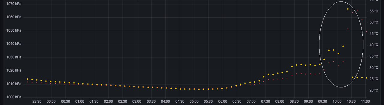

strange - isn't it? Correlating this fact with internal temperature and pressure readings (temperature - blue, pressure - orange)
temp vs pressure
can be interpreted like this: during initial heating phase, temperature inside rose and with rising temperature, rose internal pressure. Then something happened, pressure rapidly lowered and stayed low despite temperature changes. There is a possibility that protective cap was blown open by the internal pressure, and - as we know that our connector isn't waterproof when left open without a plug installed, from this point external air entered and leaved freely, keeping constant pressure despite temperature changes.
EDIT (2024.05.27)
Solar radiation test was repeated and every day of the test (two sunny days in the sequence), connector de-capping was observed, so it seems to be a valid and repeatable observation. The next question is - if it is a feature of this one connector piece? I have another one, so I can swap them and test again.
EDIT (2024.05.29)
After swapping MRD-BG04 sockets between two enclosures (one from current challenge and one from last year's) test was repeated and the result is the same - it seems that when temperature rises sharply, internal pressure forces protective cap open (had two opening events during two day test). Another - reference - enclosure, purposefully depressurized, is not displaying this behavior.
