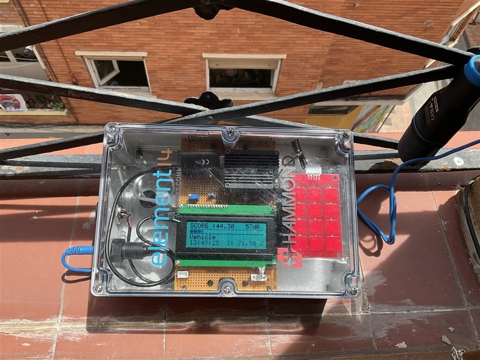

    javagoza over 2 years ago in reply to JWx
    It's strange, maybe it's a manufacturing defect. I now have the device working in full sun, completely closed, there is an outside temperature of 25º C / 77F and the temperature of the raspberry has reached 75ºC / 167F and the cap is still in place, hot because it is black but it has not come off.

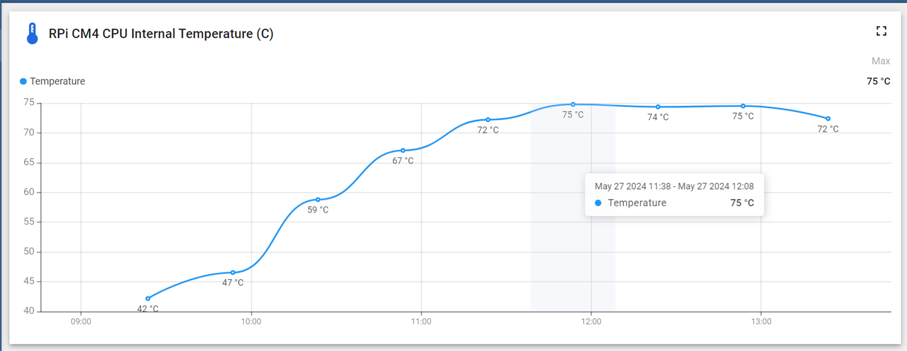

  • javagoza
    10:00 47 C
    10:30 68 C
  • javagoza
    javagoza over 2 years ago in reply to javagoza
    the little valley is the shadow is the shadow of the railing on the heat sink
