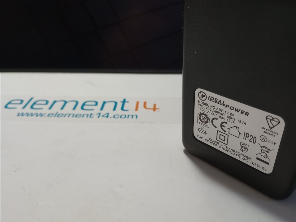

In my application I had requested the AC power supply to allow me to test out my AC options and I received a 24VAC power supply from IDEAL Power, which looks “ideal” for my purposes.

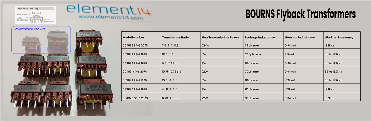

Looking at the kit, I think I have quite a few to choose from.

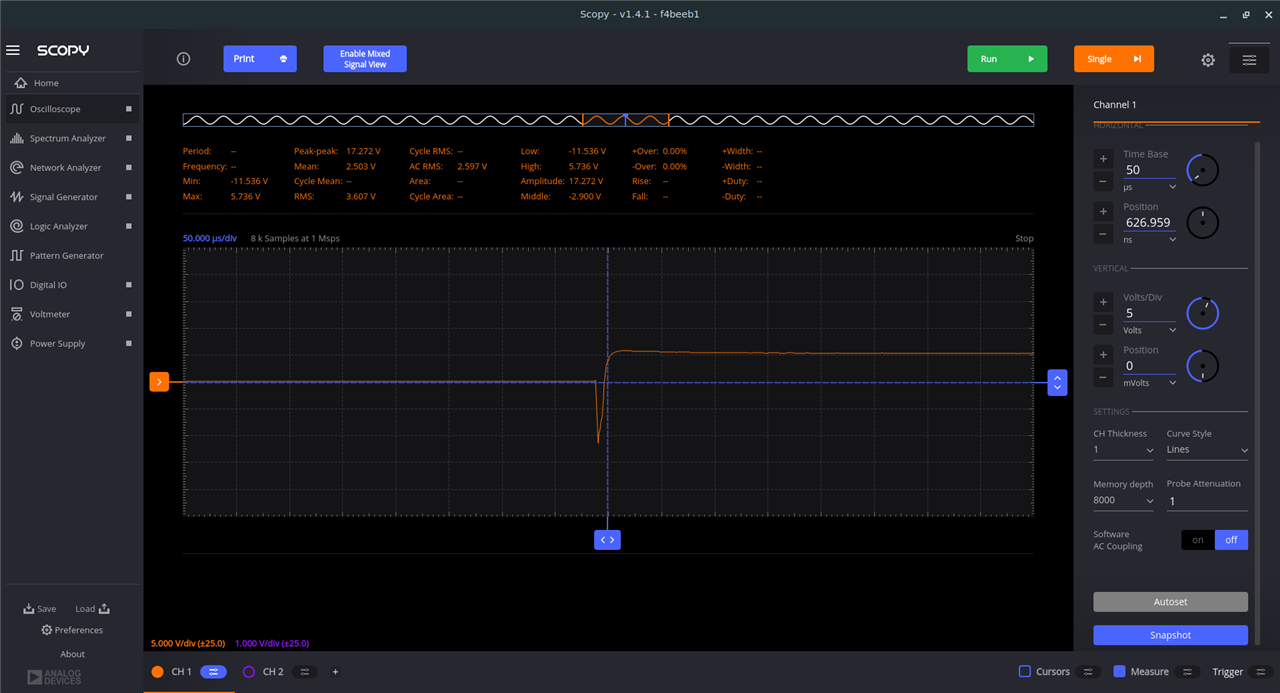

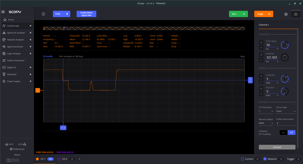

I somehow had thought that you could get the switch closed (ON) indefinitely. When testing, all I could see on my oscilloscope was that the primary voltage drops… as shown here when I momentarily keep the pushbutton on.

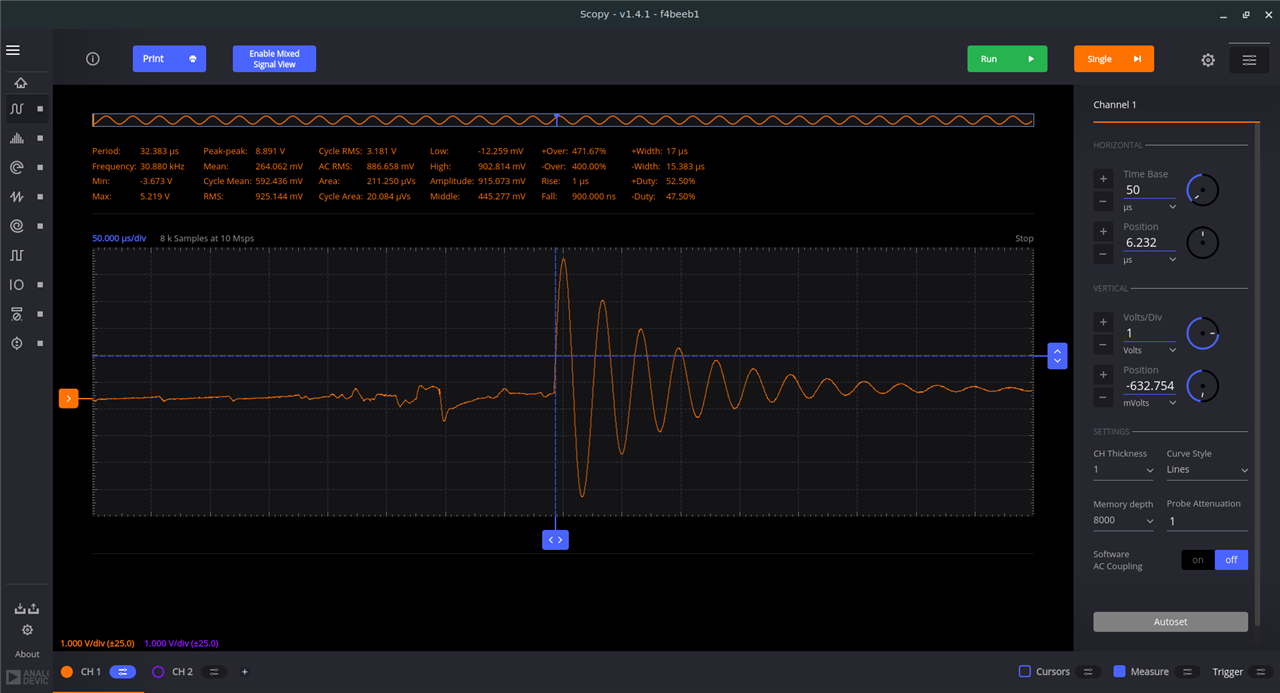

Here in my circuit I used an LED instead of a standard diode on the secondary side to help visualise matters (I relied on the fact that voltage and current flow was momentary).
I could now observe interesting behaviour during button debounce on the secondary side, as shown, but it still not help my understanding of the fundamental concepts when using DC power. This is the secondary voltage through the diode:
And this is the voltage across the capacitor (when there is no load - open circuit).

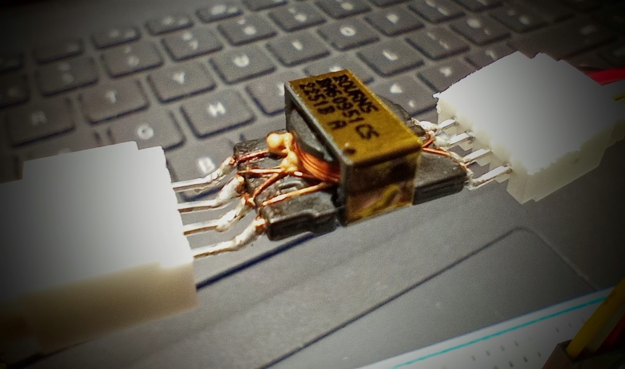

So, I took matters to the extreme, where I hooked up a 6A 15V power supply to the primary coil and held the switch on... and as mentioned in my introduction, this did not end well.
Anyway, I have finally grasped the meaning of “During this portion of the cycle, current in the primary is ramping up over time to store energy (= ½LI2)”.
