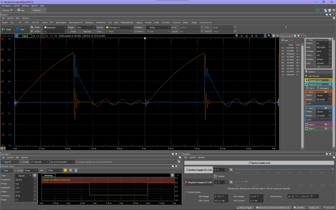

After seeing the simulation results, I went to build the circuit:
flyback converter on a breadboard, 10 ohm sense resistors are paralleled with jumpers, to use either of them depending on what's being measured
 a look at the MOSFET and output stage of the converter
I also added 10 ohm resistors in series with both the input and the output to take a look at the currents, which according to the (close to) ideal simulation should look like this:
 a simulation of the almost ideal circuit, showing the primary current and output diode current
(that ringing on the primary side current has to do with parasitic components in the mosfet, which we'll see later)
but since my real life components are far from ideal, I went ahead and measured everything using the impedance analyzer, and then modeled the circuit in LTspice as well as my measurements allowed me to, and now the current waveforms became spicier:
 primary and diode currents with more realistic components
you might also notice that the transformer coupling is no longer 1. This is because with real components we have less than perfect coupling, and the uncoupled part is what becomes the leakage inductance.
We can calculate the coupling factor like this:
This equation also assumes no losses, but if we model the transformer as measured, ideally coupling the magnetizing inductance and adding the leakage inductance in series, uncoupled, as well as taking into account the series resistance of the windings, we get a very similar result, just with larger amplitude ringing as you can see here:
now let's take a look at the MOSFET and diode currents in the real circuit:
 a real measurement of the circuit, with the jumpers across the 10 ohm resistors removed
we can see that they are an almost exact match to what we see in the simulation. From this we can now safely assume that the circuit will behave just as in the simulation once i bridge the 10 ohm resistors. We won't be able to see the currents anymore, but knowing that the circuit behaves just as expected from the simulation, we can use the results of the resistorless simulation, together with the voltage measurements of the real life circuit to get the complete picture of what's going on with our circuit.

    I couldn't wait to post this in another blog, so the simulations here will also serve as sneak peeks: This is how the currents look like with the unshorted aux leakage measurement, this looks the furthest…

    Can't believe I didn't hit send when i wrote a reply to this. Thank you javagoza, measuring at the ringing frequency, and with the windings to be used is indeed how it should be done, and while the measurement procedure is the same, the value obtained at the ringing frequency will be lower. One interesting thing about this is that by performing the measurement with the other winding (or windings, depending on which ones you will use) you're also getting the value for the referred leakage of that winding, so you can perform the measurement on just one side to then calculate the snubber.
    Here you see the frequency and amplitude of the spike and ringing at vds are almost identical in both circuits. not being the same because of measurement error. (ignoring that these are the values obtained at 250KHz and not the ringing frequency) So measuring leakage on one winding really is enough!
    Thanks again! Slight smile
