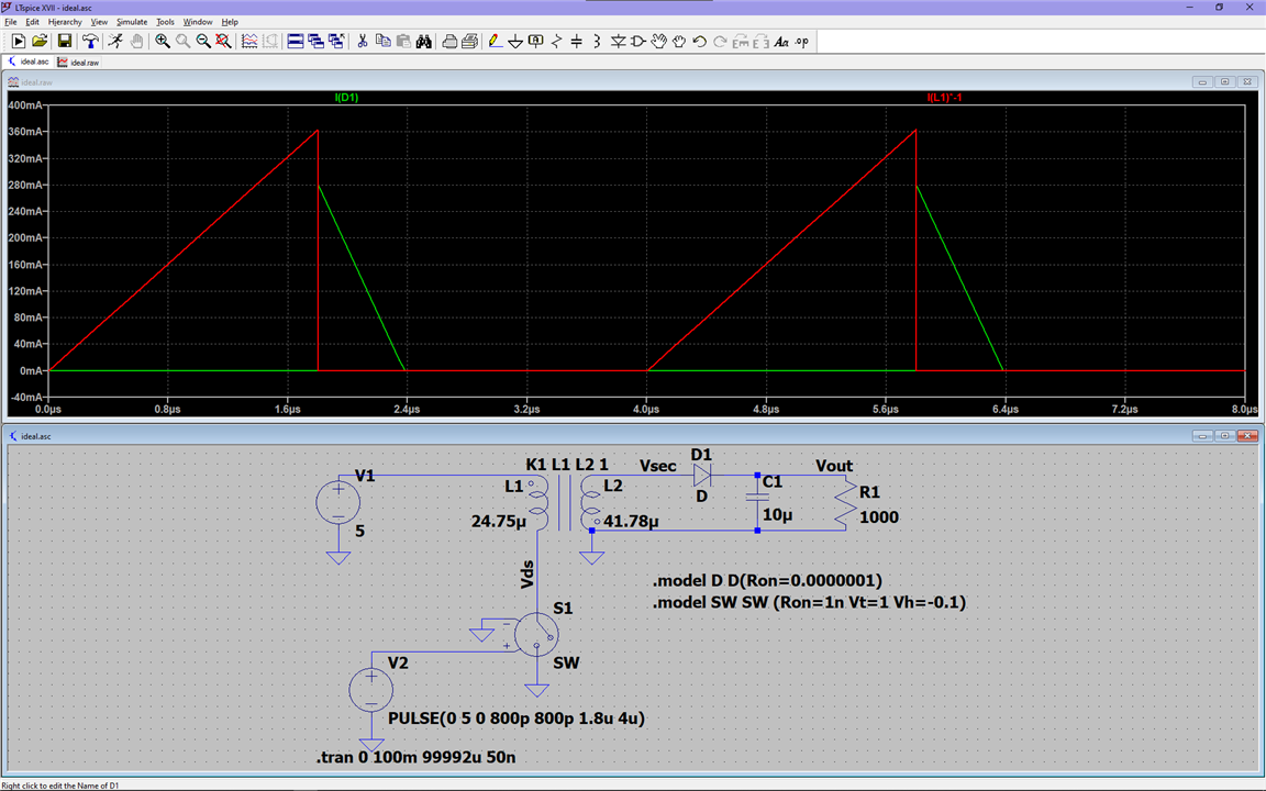

now let's take a look at
The Flyback converter topology
flyback converter schematic with mostly ideal components
This is the simplest flyback converter schematic representation, and in this case, the components used are all ideal, except for the MOSFET, as I couldn't get LTspice to run a proper simulation with an ideal voltage controlled switch. The selection of the MOSFET and that of the other components is such just because those were the components I had lying around, it was random, and after all, this was just meant to be a proof of concept, to see if the circuit would work.
Using this almost ideal schematic, we can see how the voltage output equation for a flyback converter (in DCM mode) gives us a close match to what we see in the simulation, where R is the load resistor, T is the period of our switching frequency, D is the duty cycle, and Lp is the primary inductance (primary inductance for the ideal case only):
 a look at the input and output voltages
Lp should technically be the magnetizing inductance, but for now, as the modeled transformer is ideal, the entire primary inductance is assumed to be magnetizing.

 a simulation of the almost ideal circuit, showing the primary current and output diode current
(that ringing on the primary side current has to do with parasitic components in the mosfet, which we'll see later)

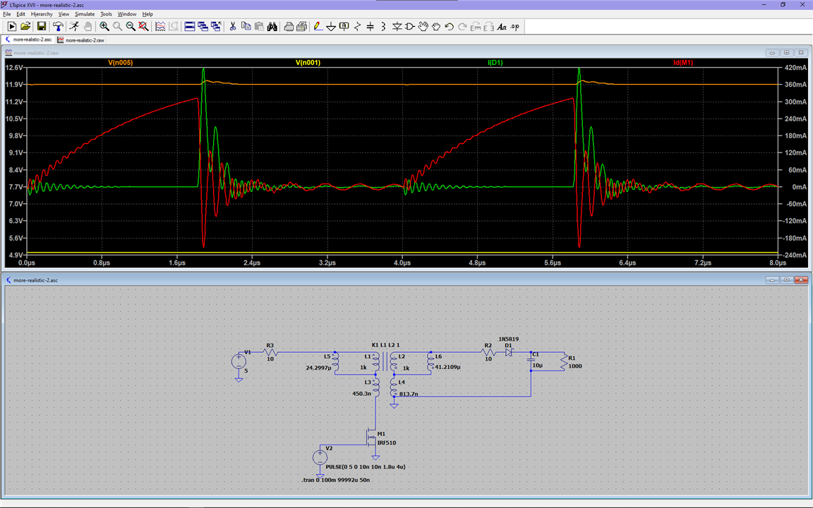

but since my real life components are far from ideal, I went ahead and measured everything using the impedance analyzer, and then modeled the circuit in LTspice as well as my measurements allowed me to, and now the current waveforms became spicier:
 primary and diode currents with more realistic components
you might also notice that the transformer coupling is no longer 1. This is because with real components we have less than perfect coupling, and the uncoupled part is what becomes the leakage inductance.
We can calculate the coupling factor like this:
This equation also assumes no losses, but if we model the transformer as measured, ideally coupling the magnetizing inductance and adding the leakage inductance in series, uncoupled, as well as taking into account the series resistance of the windings, we get a very similar result, just with larger amplitude ringing as you can see here:

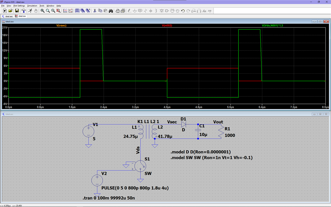

    I couldn't wait to post this in another blog, so the simulations here will also serve as sneak peeks: This is how the currents look like with the unshorted aux leakage measurement, this looks the furthest…
  • Anthocyanina
    Anthocyanina over 2 years ago in reply to javagoza
    I was now able to simulate a much closer to ideal circuit, and thse are the idealized waveforms. when it comes to currents, it is as you say, one winding is not conducing at all while the other is:
    But there is still a voltage induced in the secondary, just blocked by the ideal diode, which has no capacitance, breakdown voltage, or recovery time, so it acts as a perfect barrier:
    you can see in the orange waveform, the secondary voltage is highest while there is current flowing through the diode, but when the current stops, the voltage rapidly drops to 0. The red waveform is the PWM, and you can see that when the switch is on, there's of course 0V across what would be Vds if it was a perfect MOSFET, but there is voltage being induced in the secondary winding, and this voltage also is reflected back to the primary, inverted (so we measure from Vds to V1) and reduced by a factor of the turns ratio:

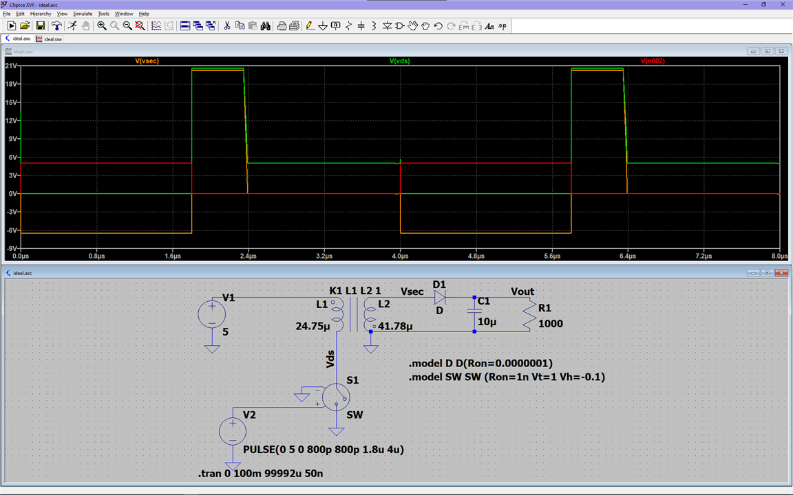

    Here's how it looks like reflected:

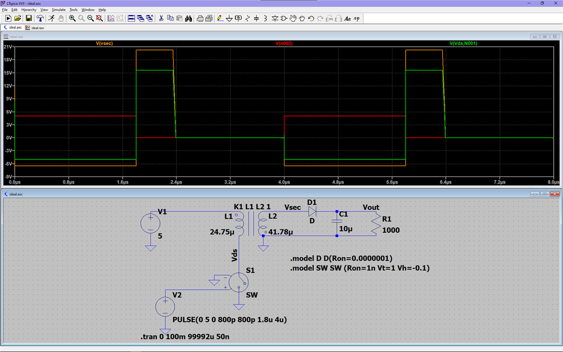

    and here's how it looks like when scaled by the turns ratio:
    So you can see, the voltage induced in the secondary, across the entire period does actually make itself present in the primary. This is actually a very useful characteristic of these converters as it allows the use of primary side regulation, by having the controller measure the reflected voltage to monitor the output of the secondary, meaning there would be no need for an opto-isolated feedback coming from the secondary.
    When it comes to real life circuits, wtih non-ideal components, we see that there is a bit of leakage current flowing through the windings(as seen in the screenshots in the blog when i'm taking measurements and the realistic simulations. This current keeps flowing because of the properties of inductors, but it is clearer to see why if we look at a more comprehensive model of the transformer:
    In this model, we take the magnetizing inductance out, and replace it with an ideal transformer. The ideal transformer supposedly has infinite inductance, but that's impossible to simulate, so an arbitrarily high inducance of 1 kilohenry was used for both windings of the ideal transformer, and you see, while there is a measurable change in the behaviour of the circuit in the simulation, it is still significantly close to what it was before, especially considering the transformer part of the circuit is now a 1:1 transformer with ridiculously high inductance. This reflects the behaviour of what we call a coupled inductor, a more accurate term for our flyback transformers.
    Now it should be clearer why the current doesn't abruptly stop like it does in the ideal simulation, it has a path to flow through in the form of the ideal transformer windings, but i think Sam Ben-Yaakov explains it much better than I do:
