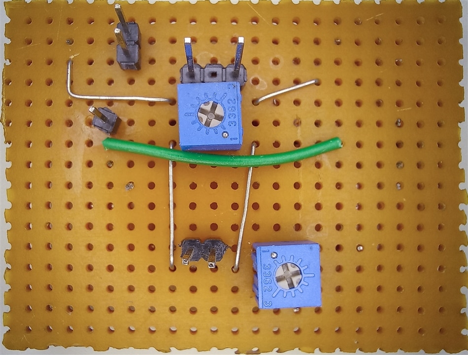

A bit over a year ago I was having a blast learning about analog computers and dynamical systems, and I wanted to do a presentation on that for my differential equations class, so the only reasonable thing to do was to build one of the chaotic attractor circuits out there, and what easier than Chua's circuit?
I present to you, the ugliest analog computer:
And it gets worse:
This was built right before class, and while usable for the class, the horrible job i did (or failed to do) at making it presentable has been haunting me ever since, and now is the time to right that wrong and while I'm at it, also integrate it with a power supply of its own.

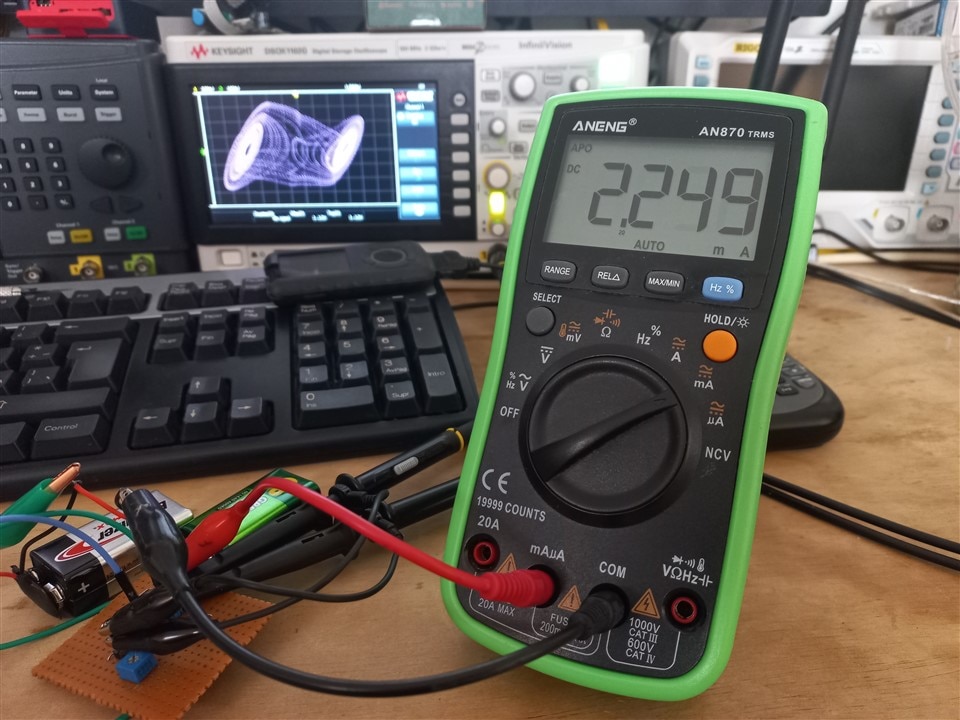

and to get an idea of the current I put the multimeter in series with both the positive and negative rails, and got about 2.3mA on each rail when the circuit goes chaotic:
This low current might be an advantage or it might turn out to be problematic, as the duty cycle might end up being too low to be reasonably achieved and I'm not going to be regulating the output using feedback, but we'll see!

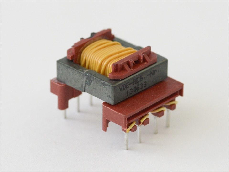

This group is the E 20/6 lineup of the Smart Power Transformers set, and brings home the highest power rating from the entire kit, with each of them being rated for a maximum of 22W.

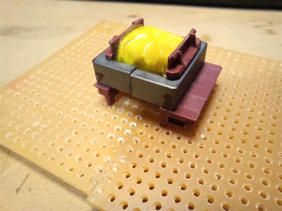

These transformers, while using a close to standard 2.54mm prototyping-friendly 2.5mm pin spacing, have the pins of the primary and secondary staggered:
The pins in this configuration won't fit in a standard 2.54mm grid, but for prototyping, we can easily get around that minor inconvenience by splitting a board then gluing it back together like this:
094929 tells us this about itself:
And it's schematic looks very promising:
Our first contestant is going in strong. It has two 12V windings rated at the same current, which means they must be identical, and not only that, it has an auxiliary winding very close in number of turns. For our current requirements, we could use this auxiliary winding as our primary and we're set! But let's not chant victory yet, 094929, it's time to verify that what you tell us is true.
Just what it told us. Nothing like an honest contestant. Our chaotic attractor is looking at this one with much interest!

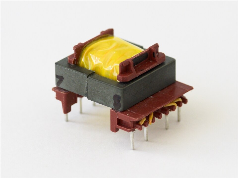

These are one half of the E 16/5 lineup of the Smart Power Transformers set. They are a bit smaller than those in the previous group, and are also designed for lower power. The two in this group (highlighted in green) are capable of handling about 9W of power, which would be more than plenty to satisfy our chaotic attractor's requirements. These transformers don't come with auxiliary windings but use instead shield windings. What i could find on shield windings is that they are used for EMC purposes and not as a regular winding, so this might rule out their use in our application.
These transformers use a less prototype-friendly pin pitch of 3.81mm, and the primary and secondary pins are also staggered, with the middle 2 pins on the secondary side being 5.08mm apart:
Playing around with these using standard prototyping PCBs and breadboards may not be the easiest task, but let's see if their electrical characteristics can compensate for that and gain the favour of our chaotic attractor.
