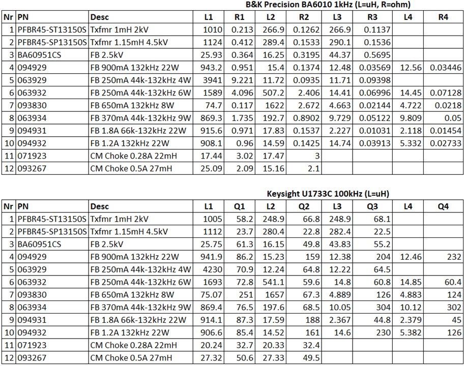

Measurements with an LCR Meter
Some of the key specifications for flyback transformers include inductance, so it seemed appropriate to try measuring them using an LCR meter.
I decided to use the B&K Precision BA6010 Battery Analyser as an LCR meter to perform some measurements. This meter is intended for use in measuring AC internal resistance for batteries and acts like an isolated 1kHz AC LCR meter. While its ranges and accuracy may not be as good as a proper benchtop LCR meter, it’s more accurate than most handheld meters.
To back this up, I decided to also use my Agilent (now Keysight) U1733C Handheld LCR Meter for higher frequency, 10kHz testing.
This should be a closer match to datasheet testing conditions, although I was not able to match the test current in all cases as the meter decides what current to use.
In general, the measured parameters match quite well with the datasheet specifications and measurements between equal windings only differed slightly, in part due to slight wire length and test lead positioning differences between tests. Of note is just how the inductance of the primaries are in the mH region, which is quite a lot more than I’m used to seeing on most DC-DC converter chips while the operating frequency is also a lot lower … I wonder whether this means that it won’t be possible to repurpose some of those to try driving these transformers. Nevertheless, this is a good confirmation of the data in the datasheets despite not being measured in exactly the same condition.

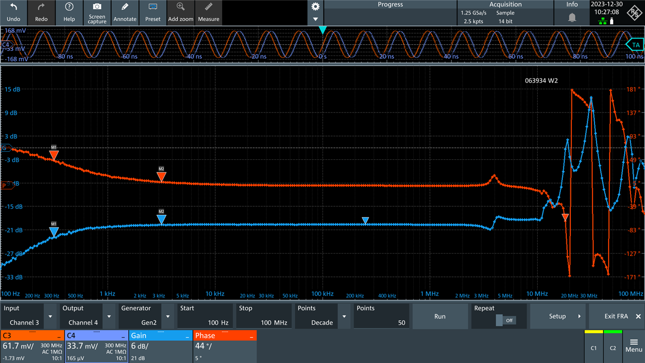

For this, I used a Rohde and Schwarz MXO4 Oscilloscope (private review still pending) with its onboard signal generator to run some bode plots on a few products.
Bode Plots
Looking at this test of a flyback transformer, it seems that the gain tails off in the low frequency end around 2kHz. I presume this is because of core saturation effects. Towards the 4MHz region, there is a bit of a dip, but self-resonance doesn’t seem to occur until 25MHz (or is that just my clip ground lead). Nevertheless, this reminds us that part of the “magic” of the small transformer is in its higher operating frequency than the mains transformer.
Testing the other winding looks similar in most ways except at higher frequencies.

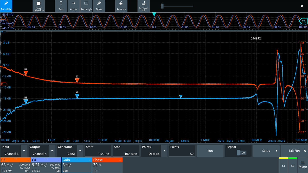

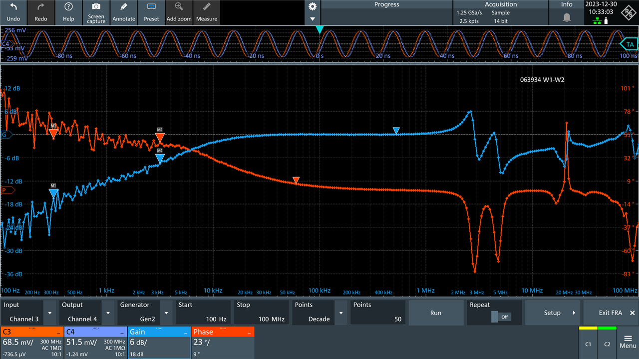

Testing between windings of equal ratios seems to suggest that maybe some kind of operation between 20kHz to 1MHz is possible, although this likely changes under load. One has to always balance things such as core losses, winding losses and switching losses when it comes to the overall converter efficiency.

Back to a flyback now – this one seems to be quite flat across an even wider range of frequencies. This is a unit with a physically larger core, perhaps that explains it?
