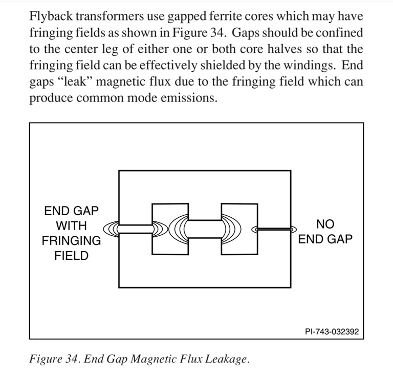

    Jan Cumps over 2 years ago in reply to Jan Cumps
    Source: https://www.power.com/sites/default/files/forum/files/AN-15.pdf

    Very interesting - I didn't realise that the parts came separately and you could just hand-wind a transformer. Seems the shielding winding on this one truly is just a shield, cut off at one end, whioe the Bourns ones seem to have both ends available or one end commoned with the primary (so I guess it can be used as bias, feedback or aux winding despite being labelled as shield).
    There are certainly different styles especially for custom design - sometimes products target very restrictive form factors so low Z-height or low overall volume is sometimes required. There doesn't seem to be much of a standard so drop-in replacement seems unlikely.

    "A closer look at the core seems to show that the gap is in the middle where it cannot be seen. Any gaps on the outside or misalignments are probably not the intentional gap. This centre gap, at least on this side, has some discolouration which might suggest some manufacturing process which may have created some heat or chemical process which may have affected the surface of the ferrite on this side."
    Yes. The gap for a flyback is the E-leg in the middle. Standard, both sides usually touch when you buy the halves. The discoloration is probably caused by a grinding process during production. To generate the correct width.
