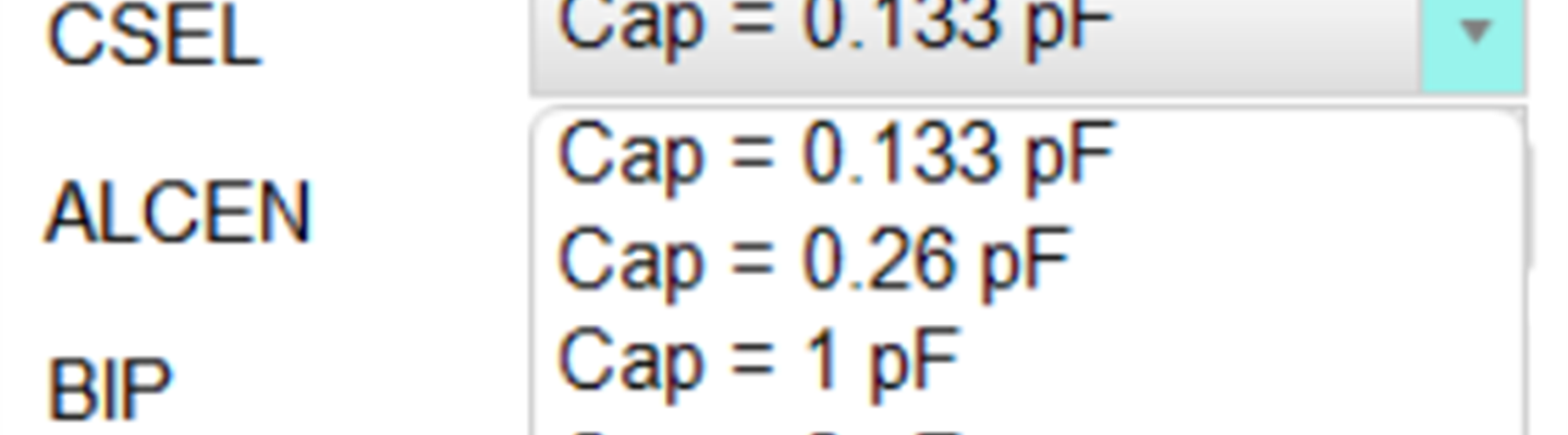

For a searching the hidden registry bits that correspond to CSEL option I tried to select different options and see how the registry values change. Computed values are shown in left column of the window. Initial state of configuration registers was 0x04 0x02 0x24 0x8C 0x08 0x0F 0x0A.
CSEL field allows four values (indicating that it is most probably 2-bit field):
I changed value from default 0.133 pF to 0.26 pF, wrote the new value to the device and check the new register values. The only register which changed is AFE (analog frontend) configuration register which changed its value form 0x08 to 0x18. This means that bit number 4 (counted from 0 changed) changed from 0 to 1.
I changed value from 0.26 pF to 1pF and value of AFE configuration register changed from 0x18 to 0x28 which means that bit number 4 changed back from 1 to zero and bit number 5 changed from 0 to 1.
Lastly, I changed value from 1 pF to 2pF. New AFE register value was 0x38 which means that bits 4 and 5 were set to 1.
Now I know that CSEL value is configured using AFE register and more precisely it is located in 4th and 5th bits. In datasheet AFE register is visualized as follows:
And Now I know that bits 4 and 5 are not the dashes, but rather they are useful field. Experimentally I deduced Reset value as 0b00 and Access Type look as standard Read, Write field.
From GUI software combobox labels I also know that value 0b00 correspond to capacitance 0.133pF, value 0b01 correspond to capacitance of 0.26 pF, value 0b10 means 1pF and finally 0b11 means 2pF.
Now the secret CSEL field was disclosed.
