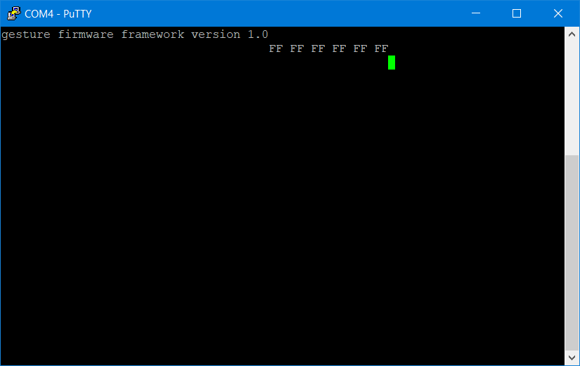

    Hi, today I tried flash the firmware to the device and my physical UART interface work when compiled with MBED OS checked to revision 0fdfcf7350896a9c0b57c4a18237677abfe25f1a and USE_UART_INTERFACE set to 1. AT least it respond to ver command. As of now I did not tried advanced commands yet. UART is on pins P3.0 and P3.1 exactly as you have connected. For sure I am attaching my build of firmware: https://misaz.cz/Public/files/max25405fw_real_uart.bin
    But, I had issues with flashing firmware to the device using bootloader. In my case after draging new firmware and waiting bootloader rebooted but FAIL.TXT file occured with description that flashing failed with error "The transfer timed out". I tired copy file from WIndows machine and also from Linux (Raspberry Pi) but in both case I received this error. Are you sure that you flashed firmware successfuly? After flashing firmware and reseting FTHR board "Maxim Serial Port" should dsiappear from Windows Device Manager. If you see Maxim Serial Port after "flashing", than your flashing procedure were unsuccessfull and your MCU still runs old (stock) firmware.
    Because I was unsuccessfull with bootloader then I used alternative way - JTAG probe. I flashed firmware to the MAX32620 MCU using PICO adapter and openocd with following command:
    "C:\Maxim\Toolchain\bin\openocd.exe" -s C:\Maxim\Toolchain\share\openocd\scripts -f interface/cmsis-dap.cfg -f target/max32620.cfg -c "init" -c "halt" -c "program D:/path/to/max25405fw_real_uart.bin verify"
    But this approach of course requires JTAG probe.
    For sure I am posting photo of my setup. I use FTHR board on breadboard. Here I connected CP2102 USB-to-UART converter connected to pins P3.1 and P3.0 of FTHR board and I also used logic analyzer to check UART signals. Last board is MAX32625PICO board which I used with debugging:
    Then I was able to connect to open CP2102 COM port in Putty and execute some commands. Note that firmware has no echo feature, so typed commands are not visible and I had to enter Ctrl + J to send \n (by default putty sends \r on enter). But after sending commands I successfully received replies from firmware:
    ver
    reg read 0 6
